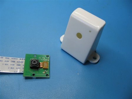

    So I received one of these today, here are some images

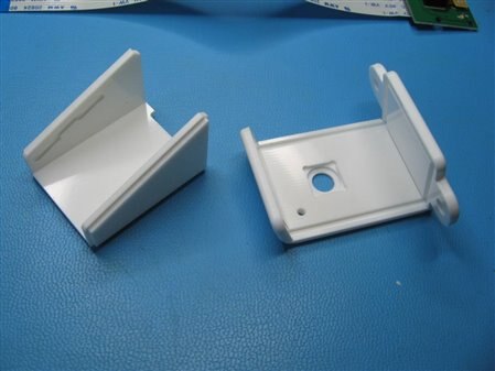

    As you can see here, the case is simply two bits of folded plastic with some grooves to keep it together
    The camera clips into the groves cut into the sides of the back of the case, it's quite fiddly to get it in there, I'd suggest removing the cable first. It's also a tight fit with some force required.

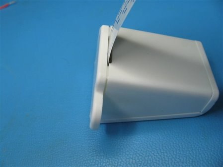

    Finally, as you've had to bend the front of the case apart to get the back into the groves it doesn't quite come back together perfectly
    notice the gap is somewhat wider at the bottom.

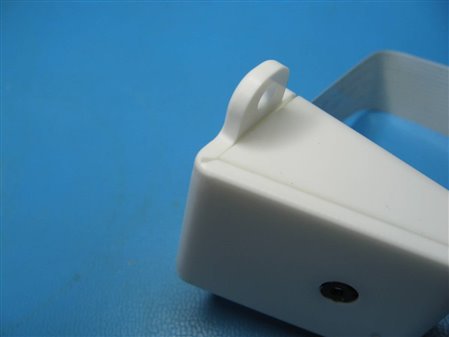

    As the plastic front has been grooved and then folded along the groove as can be seen here, it's quite fragile and it probably wouldn't take much to break it
    So on the whole it's a reasonable attempt at a case for the camera when the camera wasn't particularly designed with a case in mind.
