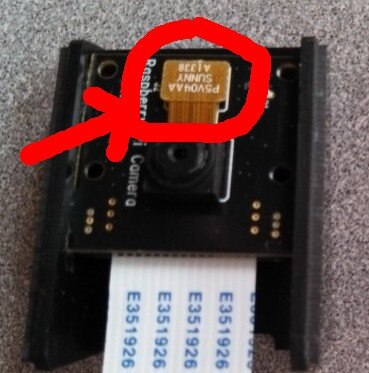

    Okay, it has been too quiet around here.  Got my Pi NoIR camera today and decided to start playing.  Well, plugged it in and started it up and had the same problems others were having that it would not work.  Saying the camera was not installed.  Double checked everything, enabled, rebooted, seated on both ends of the ribbon cable, etc.  No luck.  Then I check the small ribbon connector at the top of the lens and found that if I pushed it in, it would pop and I am guess re-seat.  Tested it and it worked, then I put it back in the case and it did not work.  Seems that camera housing/case pops that little sucker off.
    Here is the connector in question that I had a problem with
    So now I just put on the case without getting it all the way in, no pushing, and here is my test.
    e14 Contributor over 12 years ago in reply to jwier92
    That connector popping off seems to be a common problem going by the number of reports of the same over on the RPF forums. Seem to be just your luck though, I have several cameras and haven't had any problems.
    I don't like the case much though. I got the white version a few months back and don't think the quality is at all good. One of the problems is getting the camera board to sit in the slots in the sides fully. It's a bit hard to tell from your photo, but I wonder if the camera board isn't seated fully ?  If the camera board sits too high then maybe something catches the connector when you close the case. Or I'd not be surprised if the force needed isn't causing the fairly thin PCB to flex and that's causing the connector to pop out.

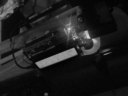

        Shipment came in the mail today, I too have outside project ideas, I wrote 2 people who corresponded about the shipment to let them know my Pi/LCD control case was also not included in the shipment.  Hopefully I can get one shipped to me.  Otherwise, this afternoon I was able to fire up the Pi, configure it with Rasbian via noobs greeting, configure to boot to desktop, enable WIFI (using WPA2), enable the camera, take a few stills and a quick vid to reflect that it is working as well as display the default LCD output of the IP as well as the CPU temp etc...  so far so good!  I have temp'd in an enclosure to get things going, also the camera housing DID arrive in the box, so all I'm missing I believe is the Pi/LCD Control Carbon Fiber case!!   Excited to get that for the review.  In the mean time, I have confirmed that it boots headless, SSH enabled and now I can get to work on it.  I am thinking cron jobs, rsync's, somthing, to a remote host on my network, then display the stills or the vid through another means, in an attempt to off load some of the work that the Pi has to deal with.  I saw a post that there is a utility that the camera is used with that negates the need for the cron style jobs.  Going to go back through the documentation and see what I can do with it.  I think I need a line item list of some links to:
    1) LCD / Control docs that are specific to button purposing and relevant configuration
    2) Camera control, automation, GUI adjustments for brightness, *color, sharpness etc...   just for example of tweaking those settings on the fly, to adjust it as a first stab in that environment (thinking command line like alsamixer sliders)
    3) Need to review what is available for the sensor capabilities with the I/O pins, maybe adding a few IR emitters to add *light, for snapping some non light photos  etc...
    4) more?
    Happy New Year all !!!!
    Eric
    Here it is slammed together in true geek/techy style!  Also, Cam housing is just temped in on one of the snap together case's posts with a screw hole full of paper and a smaller wood screw, just to hold the cam case from jumping around and orient it so that it is not laying next to the case, (in lieu of not having the coool carbon fiber case that hopefully will be coming).
