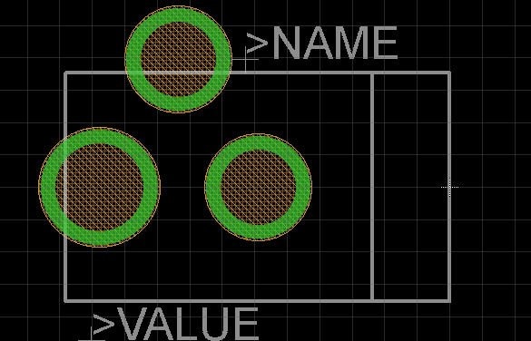

A recent discussion by Robin Gunning (Raspberry pi powersupply change from micro usb to dc power plug) led me to investigate the feasibility of creating a board allowing a DC power jack to be connected to the Raspberry Pi.
I have created my first ever Eagle Schematic but would appreciate some feedback on the suitability of the design and any comments/suggestions you may have for improvements or potential pitfalls.

    Having done some further investigation I have decided that a 5v DC PSU would be the best approach. This would reduce the complexity, cost, and inhibit any of the potential overheat scenarios.
    The output connector on the model that Problemchild referenced earlier has output connector dimensions of: 2.1mm x 5.5mm x 12mm.
    Is this size suitable, or is there a more recommended/common connector size?
    shabaz over 11 years ago in reply to gadget.iom
    Hi Paul,
    I feel the 2.1mm connector is the most common one, yes. There are also connectors with the same external diameter but with 2.5mm internal diameter.
    There is a DC connector available that will accept both sizes, but that's possibly overkill. Anyway, the same PCB footprint usually works for the 2.1mm and 2.5mm connectors
    (i.e. a footprint like the one below).

    Thanks shabaz. Is that eagle you're using there?
    Hi Paul,
    It is, I think a similar package may already be in a supplied library, I tend to make my own off the part datasheet, so I just pasted a screenshot of it.

    The problem with those 5.5/2.1mm connectors is that they are common. People will have physically compatible powersupplies lying around the house that are of a different voltage, usually 12V or more. This will fry your 'pi for sure.
    shabaz over 11 years ago in reply to rew
    That's true, if Paul wants to design for minimum user error risk, then a different connector or diameter may be an option. There are other non-technical ideas like the BBB and RIoTBoard use, where they have a big label marked 5V on the connector. I think it does work as a good reminder, a nice non-technical solution.
    I guess it really depends on your requirements Paul, and who will use the adapter (e.g. experienced users will already label their supplies or double-check before plugging in, but a kid might not). I have 5, 9, 12, 15, 24, 48V supplies all with this connector so I need to take care extra as an example, so I triple-check : )
