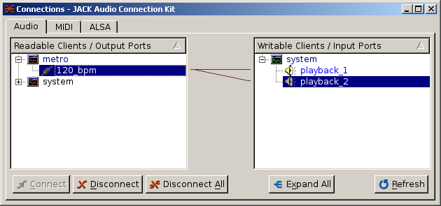

    I was not able to get a sound from jack_metro -b 120 after starting jackd on neither image.
    ecasound -i tone,sine,880 -o jack,system however connected successfully. Could this still be an issue with the cirrus driver?

    I use JACK extensively, too. I use jackd2, but it looks like you're using jackd1? I first installed it from the Raspbian repositories, but it didn't work at all (bus errors, due to packed structures). I soon found out it didn't work for anybody. This was two years ago. I found the excellent work done by autostatic and used jack from his repository for a while. Today, I use a version I built myself from source.
    jack_metro beeps nicely in my setup...
