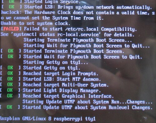

    I noticed one thing.
    When the RTC is not read well, during the boot I can read an error message on the screen, please see the image provided:
    It seems to involve the /etc/rc.local. Perhaps is there an issue in such file?
    My /etc/rc.local is below. Is there something wrong inside it?

    0 rew over 10 years ago in reply to e14 Contributor
    I would not be surprised if the driver takes a second before it has the chip up-and-running. So I would place a "sleep 1"  before the "hwclock -s".
    Does that help?
    0 e14 Contributor over 10 years ago in reply to rew
    Unfortunately it does not help image!
