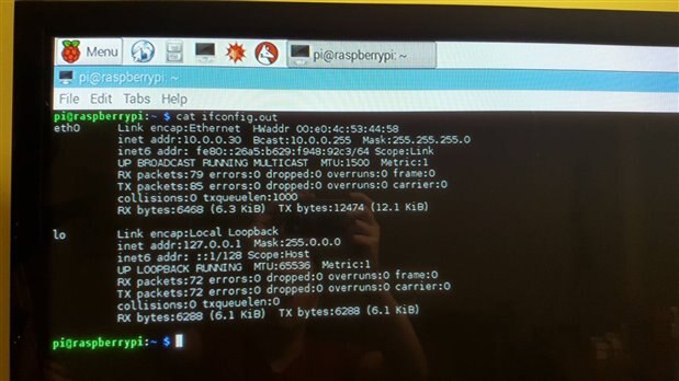

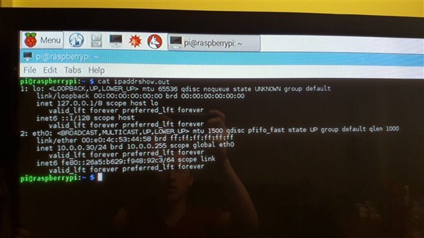

I'm having trouble connecting my Raspberry Pi zero to ethernet.
I have a Raspberry Pi 3 and four Raspberry Pi zeros. I'm a grad student in mathematics and I do a whole lot of parallel computing. I'm trying to set these up as a cluster to test my distributed code before I send it up to the university's very expensive computing cluster. I bought a handful of uxcell ethernet to micro USB adapters that you can find here: Amazon.com: uxcell Micro USB to RJ45 Network Card Adapter Converter for Windows 98SE Me: Computers & Accessories
When I plug ethernet into the Pi zero using this cable, the Pi zero is not being assigned an IP address. Is this adapter incorrect? I was hoping to use these cheap adapters as the grad student stipend isn't exactly CEO pay image.  As an additional note, plugging the ethernet directly into the Pi 3 works fine. The Pi 3 instantly recognizes the ethernet and has no problem connecting to the network.
I have tried using ip link and dhcpcd to get the network going on the Pi Zeros, but i'm stuck as I can't get them to recognize the LAN. I'm also positive that it isn't an issue with the router as I have used multiple routers (at home and at the university) and neither has worked. Thank you in advance for your replies.

    0 shabaz over 10 years ago in reply to e14 Contributor
    It looks like you've got a (most likely static) IP - 10.0.0.30.
    What is your /etc/network/interfaces file contents?

    0 e14 Contributor over 10 years ago in reply to shabaz
    Okay I see what you mean about the ip address, however when I try to ssh into 10.0.0.30 from my laptop the connection times out, and when I probe the network to see all active IP addresses 10.0.0.30 doesn't appear. Here is my /etc/network/interfaces file:
    I have tried running dhcpcd eth0 but that hasn't solved the problem.
    That is normal, because most likely your home network is something like 192.168.0.x or 192.168.1.x and you can't connect something with 10.0.0.x to it (assuming you're plugging into the switch-ports on the back of your router).
    Something else is setting this (your /etc/network/interfaces file is set up to allow this), what do you observe if you use the desktop GUI to access the wireless network settings?
    Also, by the way, this is quite an inefficient way to perform parallel processing (anything else would be cheaper, even a single Pi 3 with 4 x Pi 3 cores are cheaper than 4 x (Pi zero+USB-Eth+SDcard), and
    better performing, but I'm guessing there is reasons for it.

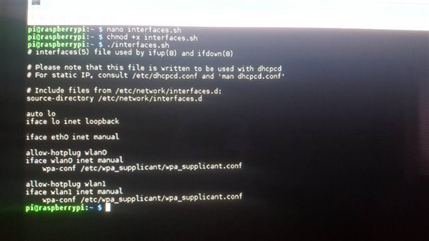

    0 Problemchild over 10 years ago in reply to e14 Contributor
    Out of interest, doesn't this set up cater for a manual interface setup?
    If you are just issuing a "dhcpd" then I would assume it uses this conf file to check  what it needs to do which isn't a lot.
    I would initially try forcing it using dhcpd<interface> ....."dhcpd eth0" in t his case
    if not use ifconfig to set up eth0 manually and put it on the same network as the working RPI then see if you can at least ping that !

    0 e14 Contributor over 10 years ago in reply to Problemchild
    Using your suggestions I was able to ssh into the Pi zero's. However, now that I'm able to ssh into them, I decided to try using my ethernet switch that has been laying around in my box of toys to get them all on the network. For some reason they are all being assigned the same IP address. I tried editing the /etc/network/interfaces file to manually assign different static IP addresses, but they are still all being assigned the IP address defined in /etc/network/interfaces of whichever Pi I boot first. When I'm ssh'ed into a Pi, after a few seconds I get an error message saying "Broken Pipe." I have to remove the IP address from my list of known hosts, and then I can ssh into a Pi zero again, but when I go back in it is often a different Pi zero. It seems that they are fighting for the IP address, even though they are different machines being connected from separate ports of the ethernet switch at the same time.
    For reference this is what I put in the /etc/network/interfaces file
    iface eth0 inet static
         address 10.0.0.XX
         netmask 255.255.255.0
         network 10.0.0.0
         broadcast 10.0.0.255
         gateway 10.0.0.1

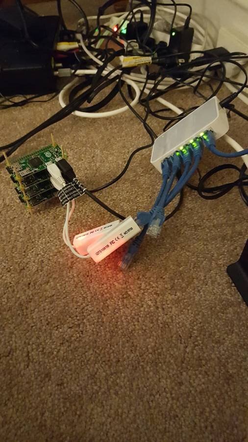

    Do you have a router connected? If so, unplug it, just to eliminate the possibility that DHCP is in (incorrect) operation.
    Just use the switch for now.
    Also, there is no way for a Linux box to look inside another Linux box to examine the IP addressing configuration and then self-configure with that configuration. No code or protocol exists to do that as far as I'm aware.
    Can you paste or attach the entire content of your /etc/network/interfaces file, for the first Pi, and for the second Pi? I get that just the IP address will be different, but it will be good to see it in detail.
    Also, a quick photo showing the router, Pi's etc would be great too. I can't see how it will help just yet, but I'm clutching at straws since your problem is bizarre.
    Just so you know, for some reason the Pi that I'm trying to set to IP address 10.0.0.30 is for some reason getting assigned 10.0.0.31. Also I have an arris 2 in 1 modem/router, so there's no way to take my router out of the equation. But yes Clem I do have a router being used. That being said, here's all the output that you requested:
    The contents of /etc/network/interfaces on Pi number 1 (ssh pi@10.0.0.31 with cat /etc/hostname showing pizero1):
    # interfaces(5) file used by ifup(8) and ifdown(8)
    # Please note that this file is written to be used with dhcpcd
    # For static IP, consult /etc/dhcpcd.conf and 'man dhcpcd.conf'
    # Include files from /etc/network/interfaces.d:
    source-directory /etc/network/interfaces.d
    auto lo
    iface lo inet loopback
      address 10.0.0.30
      network 10.0.0.0
      gateway 10.0.0.1

    The output of ifconfig -a on Pi number 2 after unplugging Pi number 1 (ssh pi@10.0.0.31 with cat /etc/hostname showing rasperrypi):
    eth0      Link encap:Ethernet  HWaddr 00:e0:4c:53:44:58
              inet addr:10.0.0.31  Bcast:10.0.0.255  Mask:255.255.255.0
              inet6 addr: fe80::26a5:b629:f948:92c3/64 Scope:Link
              UP BROADCAST RUNNING MULTICAST  MTU:1500  Metric:1
              RX packets:3618 errors:0 dropped:0 overruns:0 frame:0
              TX packets:793 errors:0 dropped:0 overruns:0 carrier:0
              collisions:0 txqueuelen:1000
              RX bytes:243745 (238.0 KiB)  TX bytes:105906 (103.4 KiB)

    A picture of my setup:
    Where the source of the blue ethernet cable to the ethernet switch is coming straight from the back of the modem/router unit.

    0 clem57 over 10 years ago in reply to e14 Contributor
    Oh my gosh, I see the problem: they all have the same mac address 00:e0:4c:53:44:58 from Amazon.com: uxcell Micro USB to RJ45 Network Card
    Which means the Chinese did not care to imprint unique ones for each adapter. I hope you can complain to where you got these.
    Clem

    0 bwelsby over 10 years ago in reply to e14 Contributor
    shabaz  clem57
    That's strange,  eth0 on both are showing the same hardware MAC address HWaddr 00:e0:4c:53:44:58
