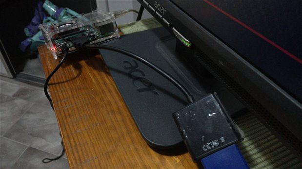

    Well, apparently my cheap little dongles work with the PI 3B!  Honestly, I never thought to even try them, since the PS4 didn't like them, and I 'assumed' the PI was a very digital signal too.  I paid about $9 Australian for them on *cough*ebay.  As others have said, be wary of dodgy sellers.
    So, now personally I have two dongles (both work) that work in the Raspberry PI, xbox 360 & XBONE.  Thanks for getting me to try it, haha!
