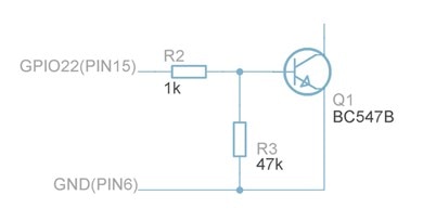

I get unexpected results when connecting a K2633 relay card to my Raspberry Pi 3 and hope someone can help.
When my Python 3 code sends 3.3V from any GPIO pin to any IN pin on K2633, the K2633 LED on that channel lights, but that relay does not energize. This occurs when the K2633 is supplied with either 5VDC from the RPi or 9VDC from a separate and isolated supply.
The four K2633 SPDT relays are 6V units. K2633 product literature calls for a 9V power supply - which I have. I realize that 5V from RPi is not enough voltage to energize the relays.
K2633 is built correctly and any relay can be forced to function properly by supplying 9VDC to the K2633 and shorting any IN pin to GND. In such a case, that particular relay will energize. Do I need to program an RPi GPIO pin to go to GND when I want to energize the relay? If so, I am not aware of how this is possible - since I understand output pins to only be capable of either zero or 3.3V when defined as outputs - with zero volts not meaning 'connected to GND'. Do I correctly understand this item?
This is a breadboard setup for proof of concept to control any relay and with nothing presently connected to C, NO or NC terminals, so final switching application is unrelated to problem. Final application will be to switch a US 110 VAC / 90 Watt ceiling fan on and off. The fan's power ratings are within the relays' capabilities of 15 A / 125 VAC. Is a different relay card a better choice?
RPi and code function properly - since I can turn on and off an LED with the circuit / program in addition to seeing 3.3V at any K2633 IN pin with a multimeter.

    Firstly, the card isn't designed to run with the Pi's output, it is designed for Velleman's USB controller card which offers a higher current 'open collector' design.
    So, you'd need an interface circuit between the Pi and the relay card. See Raspberry Pi GPIO Explained in the "Understanding Raspberry Pi Outputs" section, click on "Output Design Tips" tab, and you'll see a couple of circuits using a BC547 transistor.
    Use that circuit (remove the blue LED and its 120 ohm resistor n the first circuit, and connect up the relay card input to the top (collector) end of the transistor). The part of the circuit you need is replicated here. The GND connection in this circuit connects to the relay card too.

    0 jc2048 over 9 years ago in reply to mattwilliams
    You might consider adapting the circuit on the board to be the circuit Shabaz shows (by turning the board circuit upside down).
    If you substitute NPN transistors for the PNPs, turn the diodes round, put links in place of the LEDs, apply the power the other way round (plus to minus and minus to plus), then you'd be able to drive it from the Pi (remembering that the + on the input connector is now really the GND). You'd lose the LEDs but save yourself the bother of wiring up another board. You might even get the LEDs to work (they'd need to be turned round, too), but it's a bit tight if the Pi GPIO is 3.3V - you'd have a job getting the Rx resistor value right.
    I'm assuming that the relays don't have protection diodes built in - this wouldn't work if they do.
