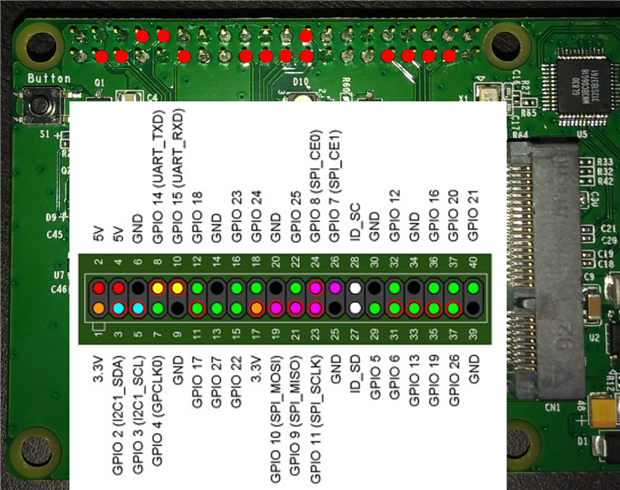

  • chris_b2b
    0 chris_b2b over 9 years ago
    The Pi Desktop board uses a loopback USB2 connector for the SATA functionality so no GPIO's are used for that.
    Since my project uses SPI & some GPIO pins i mapped them out, maybe it's useful to others too.
    The onboard MCU consumes i2c, SPI, UART and GPIO's 6, 13,19 & 26.
    Will have to see if CE1 (GPIO7) can still be used with an nRF24 device while this hat is on.
  • titou43
    0 titou43 over 8 years ago in reply to chris_b2b
    Hello
    I would like to mount this card on GPIO :
    https://shop.olmatic.de/en/ups-raspberry-pi/11-susv-pi-advanced-mobile-4260434190104.html
    It is a card for to pilot the power supply ....
    Is anyone could say me if this card function with the pi desktop ?
    I have look at the two manuals for the GPIO used :
    PI desktop :
    GPIO2
    GPIO3
    GPIO17
    GPIO6
    GPIO13
    GPIO19
    GPIO26
    Power Supply :
    + 5v (pin 2)
    GPIO2
    GPIO3
    GPIO27
    ID_SD (pin 27)
    ID_SC (pin 28)
    Many thanks
