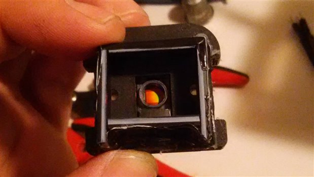

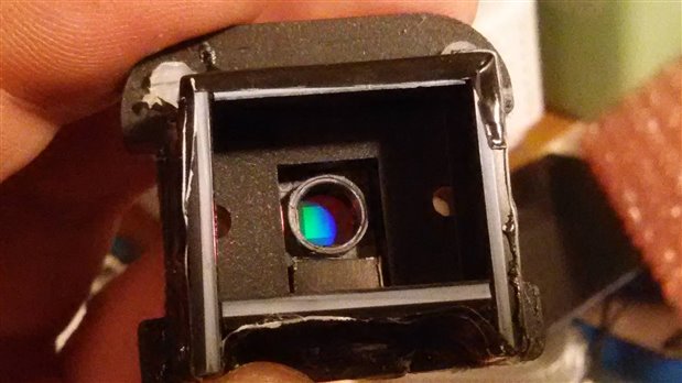

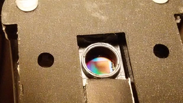

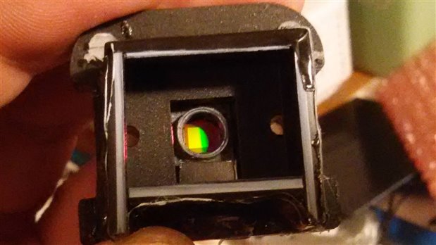

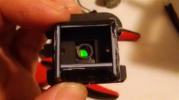

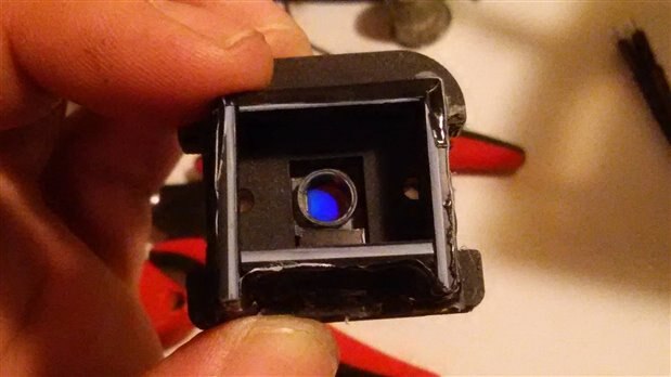

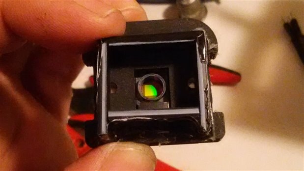

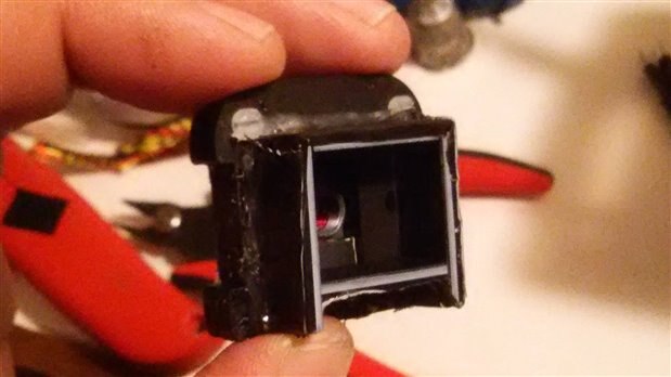

    Here is the Pi Camera with factory lense removed. This is my first attempt of constructing an adapter. I need a 3D printer or CNC to develop a better design.

    0 DAB over 9 years ago in reply to ninjatrent
    I would get a T-adapter.
    You want to place the sensor in the middle of the field of view to get the flat field over the entire width of the sensor.
    You also want repeatability, so you want a robust mount for the camera.
    • Reject Answer

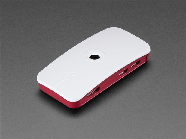

    I really wish the Raspberry Pi Foundation would release an official case for the Pi 3 and the Pi Zero W that has an adapter built in for C-Mount and M12 lens type applications. Even just a top piece designed to fit the official Pi Case similar to the official Pi Zero W case would be great. I tried the Zero's Top that has a camera mount.
    One of three tops that come with the official Pi Zero Case
    And the Official Raspberry 3 Case, with to my knowledge, no camera mount.
