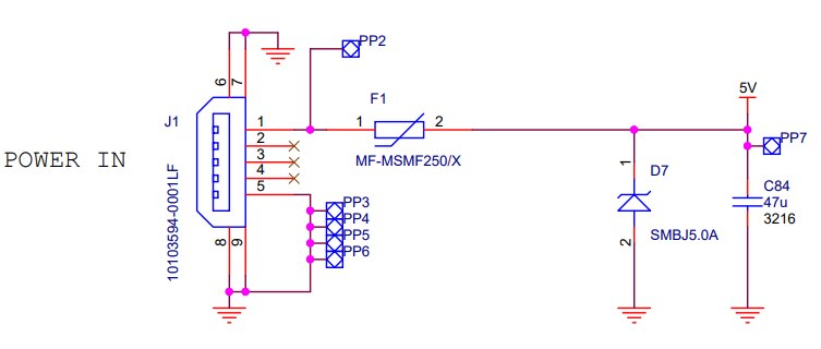

There seems to be a serious issue with the power regulator on the Raspberry Pi 3 B+, e.g.: I tried the recommended power supply, but the Pi still indicates that under voltage detected, and it keeps failing (not able to initiate anything, e.g.: sudo raspi-config, sudo apt-get update, etc.)
I bought another power supply with 5V, 3A rating, and the issues remain the same!
Can you recommend a method that I can overcome such issue(s)? Please kindly advise. Thank you.

    It sounds like a faulty Pi, if you've already tried the recommended 2.5A supply and you're running the Pi with just a keyboard and mouse attached (and no other USB devices).
    If you can check with another Pi 3B+, you can confirm if it is the Pi, or the supply that is faulty.

    Do you have a meter that you can use to verify that the voltage to the Pi is 5 volts? If possible you could also measure the current draw using the meter's ammeter. This would give you some definite ideas about where the problem lies.

    I had the same problem. I checked on two different power supplies. This is a cable issue! It was not until I used a short and thick cable that the error stopped. I checked three different cables.

    What is the "recommended" power supply you've tried?. I've tried few good reputation power supplies in my experiments -incuding adapters for tablets which are around 2.1A-, when the Pi was running with the Touch display, I was getting the low-power notification icon until I started using the official Raspberry Pi Universal Power Supply.
    Another thing that may affecting the power delivery to your RPi is you USB cable. I personally would check those before concluding it is a faulty RPi case.

    I agree on the USB cables - I have had problems with them in past and I think they are sometimes overlooked.  Avoid the long cheap ones in particular.  There is an informative video on the topic here: https://m.youtube.com/watch?v=n70N_sBYepQ&t=14s

    I tried them all, but the yellow lighting bolt still showed up, and the voltage drop for most cases is about -0.4 volt. The unit is functional (not trying to reboot) in one of the power supply with the yellow thunderbolt; I ordered 3 more units to see if this is a bad unit - I will let you know the results when I have a chance to test them.

    I have a PI 3B +, had similar under voltage warnings, both in Debian Stretch syslog and yellow flash icon on my connected official 7" screen (I don't use any GPIO voltage bridging). I use an iFi power 2.5A rated switching PSU with micro usb connected to the PI. I also fed the screen with another separate micro usb power source. With this setup I had voltage underruns every now and then during the boot sequence.
    PI<----angled micro USB cable/USB-A male 0.5m---> <----micro iFi USB female A adapter/DC pin cable 0.1m---> <--DC PIN cable to iFi PSU 1.5m? ---> wall DC 230V/50Hz
    I resorted to solder the angled micro USB connector to the DC-pin adapter, removing about 0.5 meter of cabling and a possibly weak USB A female adapter used above.
    It resolved the issue. It would have been interesting to use an oscilloscope, which I don't have, to monitor the improved voltage stability.
