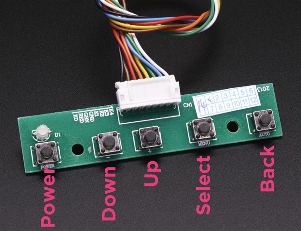

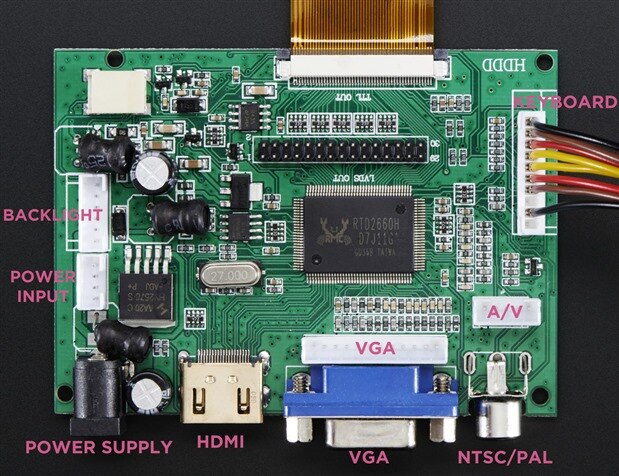

I just bought a 7" LCD TFT Display 1024*600 HDMI VGA Monitor Screen Kit for Raspberry Pi 3. It came with no documentation I generally know how to go about setting it up but I was wondering if someone has recently done it and could point me in th eright direction A picture of what I got is attached. I intend to use it with RPi 3 B+ and Rasbian Stretch.
The specs in the listing say it will require 12 V but the power cable supplied has USB connector at the other end! Guess, I can always try it with 5V. The other question is whether any edits are required to the config file?

    The kit seems to be an LCD and a scaler-input board with a separate front-panel button PCB.
    For the Raspberry Pi, it will probably be best to use the HDMI output from the Pi into the scaler input for the clearest picture. The scaler board will need 5V - hence the USB to barrel jack provided. The screen's flexible flat cable connects to the scaler board directly. The front panel button PCB will connect via the included multi-way ribbon lead.

  • korn
    0 korn over 7 years ago
    Looks a lot like the one I got from Adafruit except they dont have the remote.
    worked fine with a windows 10PC. With the PI you may have to tweak the config a bit.
    One thing I found is make sure the screen is powered up Before the PI.
    If the Pi boots first it goes into the wrong resolution.
    You may just have to change the boot file options for HDMI to force what settings you want then boot order wont matter

  • korn
    try their settings as a start.
    Adafruit puts a lot of effort into their docs...
    https://learn.adafruit.com/hdmi-uberguide/2299-display-no-touchscreen-1024x600-hdmi-slash-vga-slash-ntsc-slash-pal
  • korn
    they also sell just the io board. and have the data sheet available.
    https://learn.adafruit.com/hdmi-uberguide/rtd2660-hdmi-vga-ntsc-pal-driver-board

    0 shabaz over 7 years ago
    Hi Abul,
    I have something similar, although I don't really use it with the pi (because the display resolution was low for the one i had - but it was useful for non-Pi scenarios).
    It just works when connected, it likely sets itself up to match the resolution settings as best as it can manage, using the out-of-band channel that is over the HDMI connection. And the buttons could be used for tweaking settings or you may find no adjustment is needed at all. These displays should be handy for connecting to games systems (but regrettably my Nintendo doesn't have HDMI : ( or converting a Pi into a retro games system, there is a very huge thread on it here: PIK3A: The Raspberry Pi 3 IKEA Retro Gaming Table
