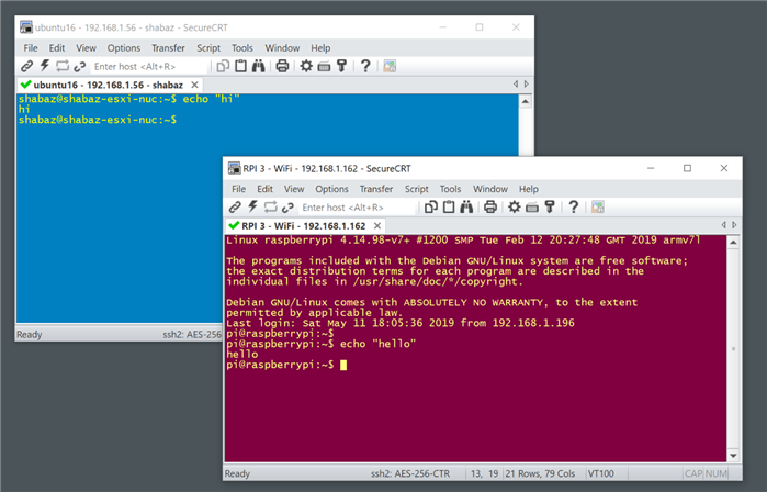

    Just for reference, if you've already got a PC that you use for day-to-day stuff, then if you don't need graphics (or don't need intensive graphics) there's no need to attach a keyboard/monitor/mouse to a Pi, it can be accessed using the remote methods mentioned above, from your PC. My Pi is not connected to display/kb/mouse, just to the home network. I connect from the PC to do some work on it.
    I don't use the graphical view, so this is how it looks like from my Windows PC (red is Pi, blue is a different Linux machine.. but the same method can be used for many Pi's). So, for graphical method or not, it mainly depends on the end application and also on what you prefer, and desired mode of use - some prefer a separate keyboard/mouse/display).
