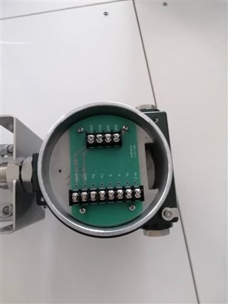

I am considering purchasing a coriolis mass flow meter that emits pulses for a project. I know it is quite common to read volumetric flow meters with the pi but I cannot say the same for the mass flow meter.
Now my question is this; if I purchase the coriolis meter, will I be able to hook it up to the pi as easy as the common flow meter and write code to determine flow rate and volume ?

  • Problemchild
    0 Problemchild over 7 years ago in reply to netromaster
    What electrical interface does it have?
  • netromaster
    0 netromaster over 7 years ago in reply to Problemchild

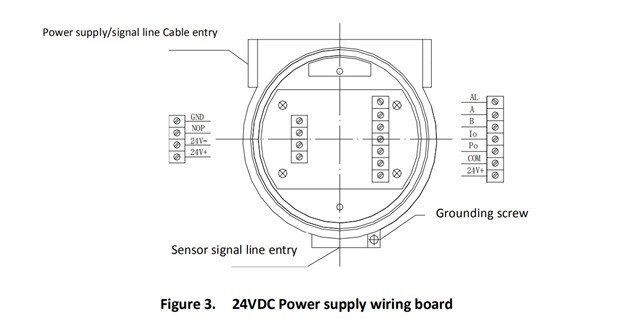

    here's the schematic and picture image of the electric interface.
    • Reject Answer
  • mp2100
    0 mp2100 over 7 years ago in reply to netromaster
    As John said, the short answer is yes.  But whether the rPi is the best solution is a follow-up discussion.  Does the manufacturer tell you how fast the pulses are generated at normal flow?  The rPi is a Linux computer, so if pulses come very fast, it may be busy doing other Linux operating system things when it should be counting pulses.  A simpler microprocessor could be better for this than the rPi.
    An alternate route could be, if the coriolis meter supports modbus, there are modbus libraries for the rPi.  You'd use the UART serial pins to talk Modbus.
