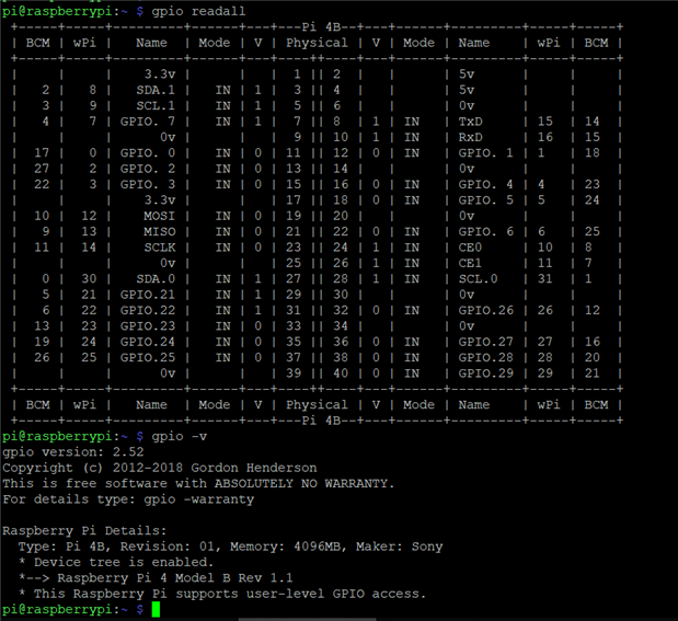

I am trying to create a simple blinking led application using Pi 3 model A+.
After some experiments it turns out that for some reason I not able to bring any gpio pin to High state.
I have tried both C, Python and gpio script to turn pin to High, but it doesn't work. I have tested both with the led and with "gpio readall", but all output are always 0.
What I did managed to change is to change the mode of the pins from Input to Output. It always worked without any problem.
Any idea what can be a reason for the problems with outputs? I just started experimenting with gpio, so  I don't think I could burn it already and I did only resistance + led tests. Also constant 3v and 5v pins work properly, so I still hope that it gpio is functional.
Any ideas are very welcome,
Thanks

    Did you try to use wiringPi  liberary to drive GPIO on Raspberry Pi?
    You may need to remove the wiringPi package and reinstall the latest one.
    # remove the old one.
    sudo apt -y purge wiringpi
    hash -r
    # Download new one and install it.
    cd /tmp
    wget project-downloads.drogon.net/wiringpi-latest.deb
    sudo dpkg -i wiringpi-latest.deb
    # check it out.
    gpio readall
    gpio -v
    if you see this. means it works properly.
