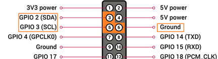

    As far as I can tell, there is already an FXL6408 on the Pi3 which controls some of the existing peripherals (eg hdmi hot-plug) and it has firmware support.  That expander is rumoured to be full, and so do we think that the additional GPIO adds another FXL6408  (which would make some sense)?  The manual also references some reserved I2C addresses:
    *NOTE: I2C1 Bus (GPIO2/GPIO3) is shared with onboard devices. I2C addresses: 0x33, 0x43, 0x44, 0x51 are reserved.
    Any thoughts on how to confirm these thoughts or how to determine the I2C address?   There's a huge performance advantage to using the firmware driver over using the character file interface from which I'd like to benefit.

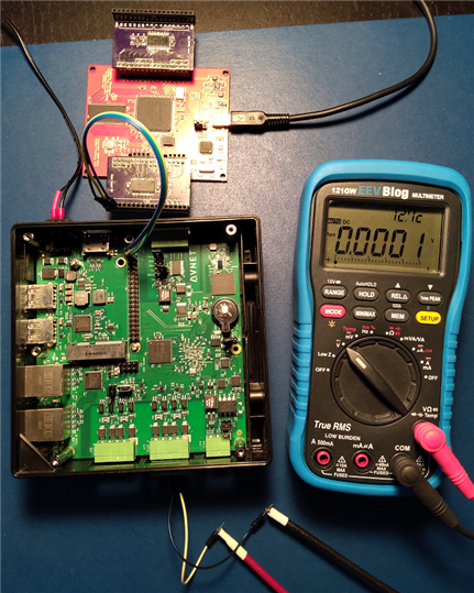

    0 Jan Cumps over 5 years ago in reply to Jan Cumps

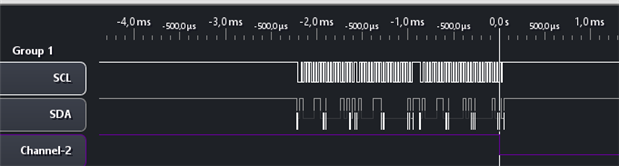

    Here are the results of the i2c capture.
    I made my analyser trigger on a change of the output O1. and captured the traffic before that event.
    Two scenarios: First I sent a 0, then a 1.
    The IC's i2c address is 0b1000011 -> 0x43

    sudo echo 1 > /sys/class/gpio/gpio201/value

    • Reject Answer

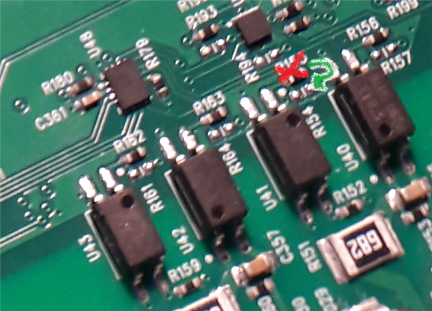

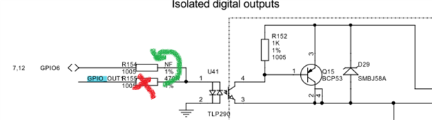

    0 Jan Cumps over 5 years ago in reply to ergouser
    In the scheme of things, the majority of time is spent in i2c. Writing to the block device is going to be a snap, compared to the 2.x ms i2c conversation.
    If you want to have direct fast control over the pins, you'll need to bring out the hot air gun.
    You can move the control from the IO expander to a direct GPIO pin, by moving resistors:
    In this case I'm showing O1. By moving resistor R156 to position 157, it is now controlled by generic GPIO6.

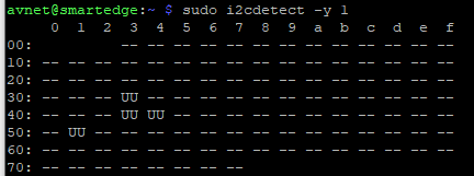

    0 ergouser over 5 years ago in reply to Jan Cumps
    Jan Cumps  wrote:
    I get this report. It matches with the note above.
    If I understand i2cdetect, the UU means that the device is busy which is validated if you try to read from the device
    sudo i2cget -y 1 0x43 5
    Error: Could not set address to 0x43: Device or resource busy
    lsmod shows these:
    $ lsmod
    Module                  Size  Used by
    bnep                   20480  2
    hci_uart               36864  1
    btbcm                  16384  1 hci_uart
    serdev                 20480  1 hci_uart
    bluetooth             368640  24 hci_uart,bnep,btbcm
    ecdh_generic           28672  1 bluetooth
    rtc_pcf8563            16384  0
    gpio_fxl6408           16384  0
    brcmfmac              307200  0
    brcmutil               16384  1 brcmfmac
    mcp251x                20480  0
    cfg80211              565248  1 brcmfmac
    can_dev                24576  1 mcp251x
    sc16is7xx              20480  0
    rfkill                 28672  4 bluetooth,cfg80211
    i2c_bcm2835            16384  0
    uio_pdrv_genirq        16384  0
    uio                    20480  1 uio_pdrv_genirq
    fixed                  16384  0
    i2c_dev                16384  0
    attiny_btn             16384  0
    attiny_led             16384  0
    attiny_wdt             16384  0
    attiny_mfd             16384  0
    ip_tables              24576  0
    x_tables               32768  1 ip_tables
    ipv6                  446464  22
    crc_ccitt              16384  1 ipv6
    if you remove gpio_fxl6408
    $ sudo rmmod gpio_fxl6408
    and rerun i2cdetect you get this:
         0  1  2  3  4  5  6  7  8  9  a  b  c  d  e  f
    00:          -- -- -- -- -- -- -- -- -- -- -- -- --
    10: -- -- -- -- -- -- -- -- -- -- -- -- -- -- -- --
    20: -- -- -- -- -- -- -- -- -- -- -- -- -- -- -- --
    30: -- -- -- UU -- -- -- -- -- -- -- -- -- -- -- --
    40: -- -- -- 43 44 -- -- -- -- -- -- -- -- -- -- --
    50: -- UU -- -- -- -- -- -- -- -- -- -- -- -- -- --
    60: -- -- -- -- -- -- -- -- -- -- -- -- -- -- -- --
    70: -- -- -- -- -- -- -- --
    After that you can set/get the registers:
    $ sudo i2cset -y 1 0x43 5 255
    $ sudo i2cget -y 1 0x43 5
    0xff
    You can then use the I2C functions of WiringPi to programmatically access the I/O.
    What you loose is the ability to control the I/O with the /sys/class/gpio/ files.
    0x44 also appears to be an FXL6408.  Any idea what that is or how to configure the gpio_fxl6408 driver to ignore 0x43 and still enable the file access for 0x44?

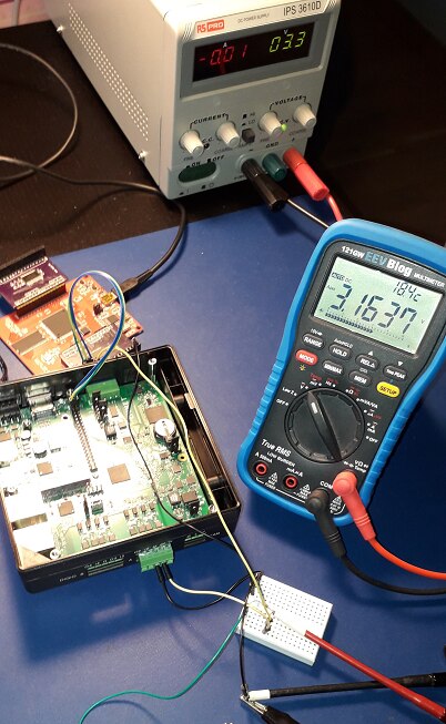

    I have some time today. I'm going to move the "DIGIO B" pins to direct ARM GPIO mode. This is a non-destructive exercise (if I am careful).
    ergouser  wrote:
    This is an interesting option.  One issue with the industrial I/O being on the I2C bus is that you loose the ability to use either hardware or software PWM.
    It works: AVNET SmartEdge IIOT Gateway: Control Industrial I/O directly from GPIO Pins
