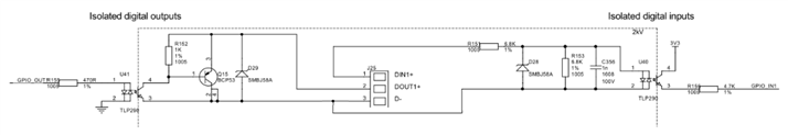

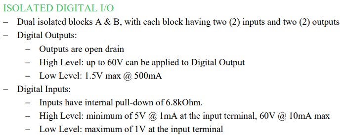

The SmartEdge IIOT Gateway (from now on: gateway) has two banks of isolated I/O - named DIGIO A and B.
All signals are isolated from the Raspberry part via optocouplers.
Each bank has 2 inputs and outputs that share a common ground*.
The input is high impedance and drives an optocoupler's input. The coupler's output is connected to a Raspberry GPIO pin.
The output is an open collector transistor, driven from a Raspberry GPIO pin via an optocoupler.
Bank A and B are isolated from each other.
Isolation is up to 2 kV.
image: I/O specifications from the datasheet
The schematic shows the first input and output of bank A. Note that output is on the left, input on the right, and the external connector is shown in the middle.
The User Guide shows the full setup for both banks.

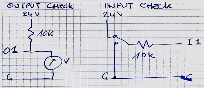

Here's an example test circuit for both input and output side.
image: simple output (left) and input test circuit
