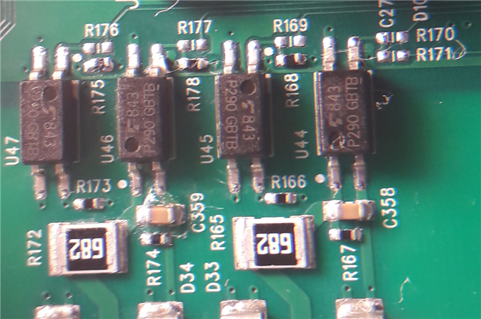

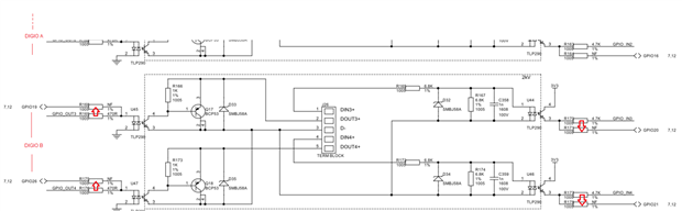

Switch from i2c based DIGIO to GPIO Controlled: Board Modifications
You switch by moving a set of resistors on the PCB. These are 0402 (1005 imperial). Tiny but doable.
I am modifying one block. I leave DIGIO A as is, connected to the port expander. The DIGIO B pins will switch to GPIO control.
image source: SmartEdge-iiot-gateway_programmers_reference.pdf (annotated)
The output side resistors are 470R, the input side 4K7.
On the PCBs, these are located just right of the upper right corner of the opto-couplers.
Each time, you have to move the resistor from the upper to lower position.

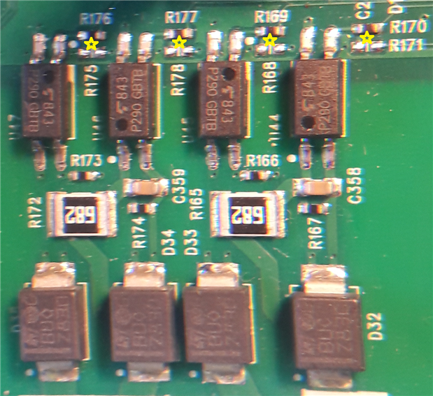

I used 460° C (yeah) and very little air - 25%. And put a big blob of flux on top so that they stay on the PCB when reworking.
Still R170 flew away. I ordered a set of new ones.
This is the result. Spot the empty location.
This doesn't stop me from proceeding. I have 2 outputs and an input to test. Once the replacement resistors arrived, I'll complete the exercise.

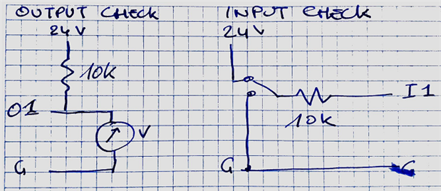

I'm using the same test circuit as in the previous post -  except for using 5V instead of 24 V, but that does not matter:

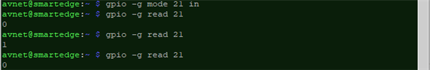

Then the input test:
avnet@smartedge:~ $ gpio -g mode 21 in
avnet@smartedge:~ $ gpio -g read 21
0
1
0
avnet@smartedge:~ $
Evidence:

    Jan Cumps over 5 years ago +2
    I think that's the lost resistor:
    Jan Cumps over 5 years ago in reply to Jan Cumps +2
    Yep That's better:
    Step 1 completed:
