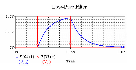

  • Robert Peter Oakes
    0 Robert Peter Oakes over 12 years ago
    what ever method you choose you need to realize that in order to get a decent output waveform with minimal external circuitry you will need to output to a DAC or PWM controller at between 5-10* the frequency you want as output so if your looking to output 20Khz. At a minimum and with assistance with output filters you should follow the Nyquist rate which would specify 2* but that wont give a very clean output.
    btw, a simple RC low pass filter will not give a sine wave it will be more like this
    this may be good enough but far from Sine
    this is more like what you need
    details can be found here http://www.wenzel.com/documents/waveform.html
    but beware this has a resonant frequency and will not work for a wide range of frequencies without varying the values.
