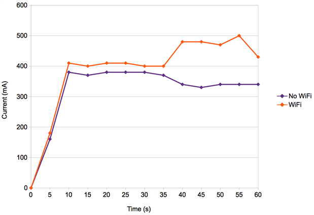

  • simon.monk
    0 simon.monk over 12 years ago in reply to D_Hersey
    Current consumption of a Pi with and without a WiFi adaptor attached as it boots up. From the Raspberry Pi Cookbook.
