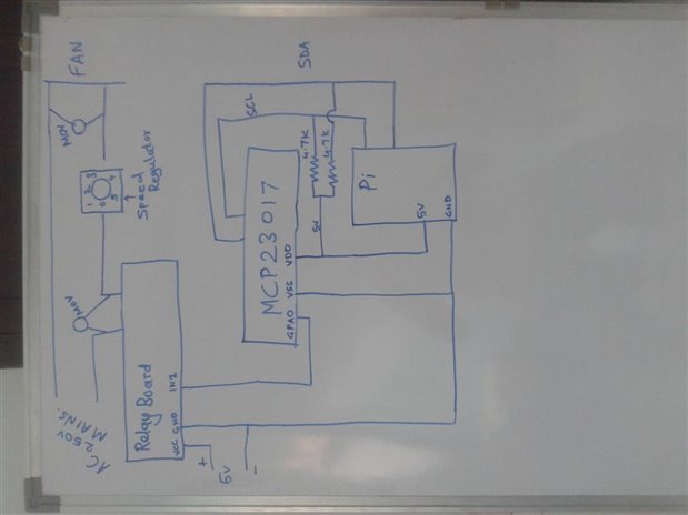

Hello,
I have attached AC fan as load to my SainSmart 8 Channel DC 5V Relay Module.
The relay board is supplied with external power supply(5V,1Amp).The relay board is controlled by MCP23017(gpio expander ic connected to my raspberry pi).
The fan is with Regulator.Sometimes when i change speed from regulator the ic is reset and relays stop working.

    Have you added pullup resistors on the SCL and SDA lines to 3v3 as I mentioned earlier.?
    A 275v MOV is primary designed to conduct when the voltage exceeds 275v AC and IMO won't fix spikes when the contact opens.
    I doubt that an induction motor fan will generate enough energy to be causing it, it will be the 5v relays.
    The question is does it happen when you don't have the fan connected.?
    What happens if you switch the mains off, but leave the fan connected.?
    If you could mark the capacitors on your drawing and repost, we might be able to see if there is something overlooked.
    You have shown a ground connection running from the RPi ground and the power supply. Is this actually connected to anything or is just a symbol.?

    The MOV shouldn't be connected across the relay contacts but across the load.
    Definitely do the experiment with the fan removed (but I think we have established that the problem only happens with the fan and that lamps are OK).
    And you must add those pull up resistors.
    How about a full circuit and some pictures - it's often hard to fix this kind of issue when the device is on the bench in front of you - it's really hard to pin it down at long distance.

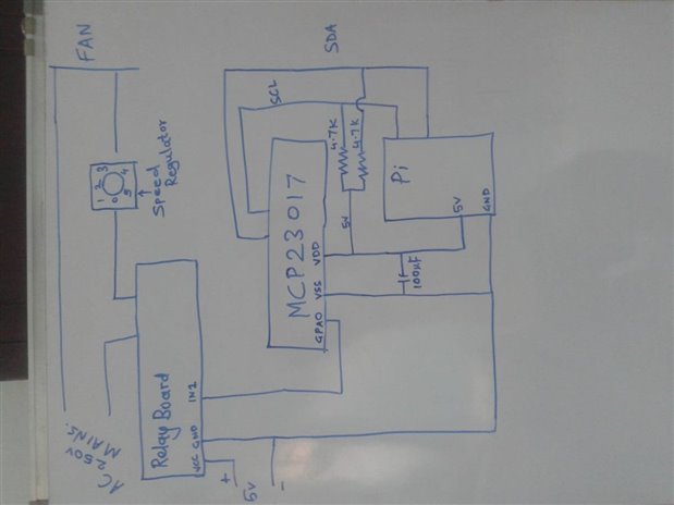

    0 e14 Contributor over 11 years ago
    1st image is the circuit with capacitor across vdd and vss which is succesfull in protecting the spikes ( reducing enough to not reset the mcp).
    2nd image is when i tried the mov across the load as well as across the relay contacts later. both places mov failed to protect from spikes and eventually reset.imageimage

    Is it always OK with the 100uF capacitor in place ?
    MK
    0 e14 Contributor over 11 years ago in reply to michaelkellett
    yes it is always ok with the capacitor. i have tried it rigorously to ensure that.

    So that sounds like the problem is solved -  I can't understand why the fan was worse than the lamps - but I don't think you need care too much if it's working now.
    yes sir its working with capacitor. but i wonder why not with mov.. as that would have further directly protected relay from spikes fairly.

    When a chip "suddenly" needs a bigger current it takes a while before the power supply can react and provide such a bigger current. (Electronics engineers call it wire inductance).
    When you don't have a capacitor near your chip, the voltage near the chip might drop to such a level that either the chip malfunctions or the chip performs a power-on-reset. This is what you were seeing.
    So, now you have a capacitor near your chip, the sudden currents can be drawn partly and temporarily from the capacitor so that neither a malfunction or a reset happens.
