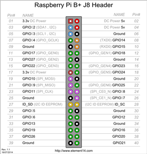

I have Raspberry Pi B+ and i just bought 8 channel relay. i successfully connected but i really need a simple code to run it to trun on and off the channel relay?
would you please help me

    To create a bidrectional (or IO) I don't know. I am sorry but I can't answer that. Next you will need to look at this diagram to help you with your code. Also you should know to look for the diagram relavent to your raspberry pi.
    Good luck and bye..
    From: Noah
    PS in case you are wondering the pinout above is for B+ the pinout below is for A.
