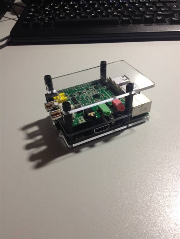

Hello, I was recently making a research about an enclosure option for the Raspberry Pi Model B+ with the Cirrus Logic audio card but I couldn't really find anything. I was wondering if any of you could have seen something that might work? I own the Pi model B with the Wolfson card and have them equipped with this enclosure (http://uk.farnell.com/camdenboss/wolfson-board-case-carbon/enclosure-box-abs-carbon-fibre/dp/2407263), but apparently the form factor is different and I can't suit it to fit he Model B+ with the Cirrus Logic audio card.

    I build today one for myself. Its not a full enclosure, more like a protector.
    I choose as base the Adafruit Pi Protector for B+. Adafruit Pi Protector for Raspberry Pi Model B+ / Pi 2 ID: 2292 - $7.50 : Adafruit Industries, Unique & fun DIY electron…
    You need the following extra parts:
    2x standoffs 4 mm long
    4x standoffs 14 mm long
    2x M3 screws 5mm long
    4x M3 nuts
    1x plate for the top, I bought a second Pi Protector only for the plate.
    1. Build together the Pi Protector with the Raspberry Pi inside.
    2. Mount underneath the cirrus board the the 4mm standoffs, take the both holes which are away from the GPIO connector.
    3. Mount on the upper side the 14mm standoffs.
    4. Mount the top plate on the 4 14mm standoffs.
    5. Connect the Cirrus board to the Raspberry Pi.

    0 prairietech over 11 years ago in reply to e14 Contributor
    Do you have a picture you could post?
    0 e14 Contributor over 11 years ago in reply to prairietech
    Here is one picture.image
