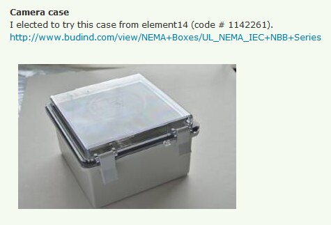

    I did one here using a 500w floodlight housing, which could work if you mount it above.
    I used a simple transistor to switch the IR leds.
    I'm not sure if birds can see IR, so you may just have a really bright torch shining in ther face.
    The other housing I'm experimenting with is this.
    I discuss it here.  Mounting 2
