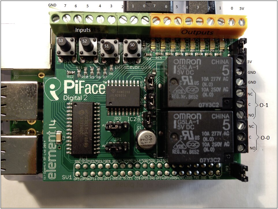

    Rather than connect direct to the PI, I would use an interface board to provide some level of protection in case of minor errors.
    The PI can be used by connecting switches directly of course and this is done all the time in prototypes etc or for a learning excersize
    The simples thing I can think of to help would be the PIFace Digital, this provides 8 Digital inputs via a buffer chip and 8 digital outputs (Two of which drive relays), the board is well suppported in the community and by the vendor
    here is a link to the canada Newark site http://canada.newark.com/piface/piface-digital-2/io-expansion-board-raspberry-pi/dp/78X5847?mckv=saxFsj780|pcrid|40869928673|plid|&CMP=KNC-GCA-GEN-SKU-PIFACE?gross_price=
    Prices will vary from region to region but this is a very popular board to extend the PI
    here is more info http://www.element14.com/community/docs/DOC-69001/l/piface-digital-2-for-raspberry-pi
    • Reject Answer
    0 e14 Contributor over 11 years ago in reply to Robert Peter Oakes
    Depending upon how many I/O pins I need I use either an MCP23008 or MCP23017 port expander.  I have an article in the Dec 2014 issue of The MagPi magazine about using two MCP23017s. I also made a PCB for a single MCP23008 that makes hooking up to the Pi easy.  The PiFace includes more than I usually need for a project; it does have the advantage of being able to do lots of things with s single board, however.
