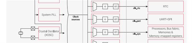

Update: Overclocking in MicroPython
One can adjust the system clock frequency in MicroPython by issuing the following command:
machine.freq(190_000_000) # set system clock in Hz
When MicroPython alters the system clock frequency, it also reconfigures the peripheral clock source from clk_sys to the external crystal oscillator.
So, if you want to maintain a high-speed SPI clock frequency, you need to set the clock mux back to clk_sys yourself by:
mem32[0x40008000+0x48] = 0x800

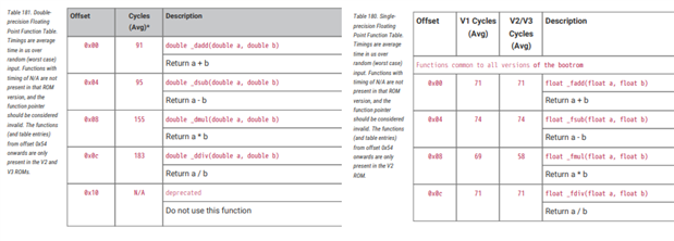

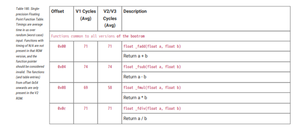

    shabaz over 4 years ago in reply to scottiebabe
    I learned a major problem with CircuitPython today; it is single-precision! I was hitting all manner of problems trying to do PLL configurations, and eventually realized it was due to that : ( I've not found out about MicroPython, but if it supports double precision on the Pico then I'm swapping over immediately : ) I've already hit two bugs with CircuitPython, one each on two separate releases, so CircuitPython is not giving me stability confidence either : ( originally I thought a benefit of CircuitPython would have been the vast amount of libraries, but of the few I tried, they all had limitations so I had to write my own code in place of the libraries : (
  • fmilburn
    fmilburn over 4 years ago in reply to shabaz
    I ran into the single-precision issue with CircuitPython also.  MicroPython can do double-precision floating and multi-precision integer but I haven't tried it yet: Maximum and minimum int and float values? - MicroPython Forum.  It can also do interrupts of some sort if I remember correctly and has experimental threads that haven't been implemented.
