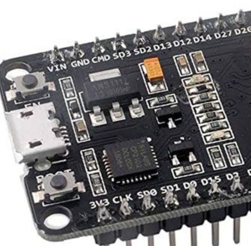

    Have you ever had serial clock or power issues with ESP32? Almost every person I've known work with it has had issues with the 3v3 power on their dev boards.

    That would be a good explanation why you haven't had problems then :) it'd make sense that the configuration the people I've known use it may have some questionable issue with the boards they've had, I don't have a link to hand else I'd share it.

    There's a weird trend to locate components in rows etc, like this:
    Not saying that's the cause (sometimes it's worse, this layout might be acceptable) but there isn't any technical reason for laying out the components like this, and that just makes me wonder if the design is suboptimal in other ways too.

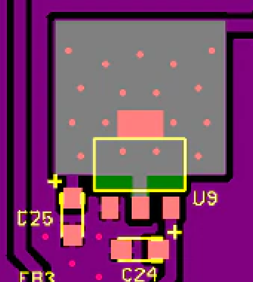

    I used the same LDO regulator as in the photo above for a project, but laid it out like this, no neat row of components, and a bit of heatsinking at least.
    Either people really like orthogonal organisation, or it's faster for the pick and place machine when it's distributing multiple components of the same type close together.
    I'm no PCB designer, though I keep meaning to try, what do you tend to aim for when you're designing like this? cost or some other factors?

    Generally I'm trying to dimension the board and place connectors etc first, at nice millimetre positions, so that I can cut enclosures easier, and then roughly place the components where they are close to others in the same sub-circuit, and attempt to just route in the sub-circuit and then occasionally move some of the sub-circuits around on the board, sometimes change the schematic to make the routing easier (e.g. I almost always change connector pinouts, that's low-hanging fruit to make routing simpler), and then once it is all routed, personally I un-route and re-route in sections, rotating components and fine-positioning them at this point, because I can't get it done well in the first go. So for me, I end up routing things almost twice. I'm no PCB designer either, so I don't know if the experienced people manage to do it right in a more efficient way.
    With the ICs like the LDO regulator above, the datasheet is usually followed if it has guidelines or example layouts, or for more complex chips I'll take a look at the reference board for them. The decoupling capacitors I'll try to get one end of them (the positive end) as close to the pin on the IC as possible, and then make the other end go to ground through a couple of vias (the other side of the board is easiest if it's almost entirely ground). If I can't achieve an entire ground on the underside, then I'll aim for only short traces on the underside if possible.

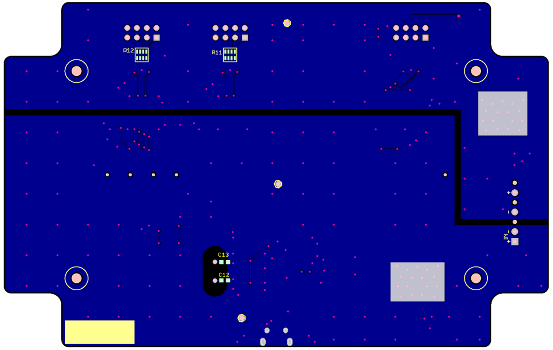

    For instance for the PCB in the example above, the underside looks like this (only very short traces where I couldn't manage to route on the top side): (The split is only because this board had an isolated ground side, that's not normally present on most boards):

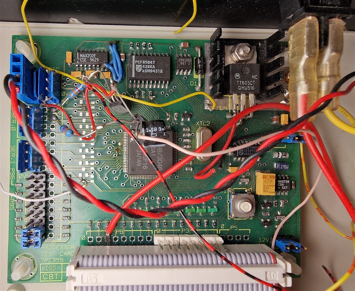

    Before microcontroller breakout or dev-boards were cheap : ) we would design our own boards each time we wanted to try a new processor. The manufacturer boards were too expensive unless you were 100% sure you were going to use the chip in a design, because the manufacturer board often had exotic in-circuit emulator on-board, and sometimes even fancy IC sockets for the target chip (even for surface-mount ICs - the sockets cost $$$) and the manufacturer dev board could cost thousands (today there are still dev-boards that cost thousands of course, but nowadays often they are for more high-end parts, sometimes lower volume devices).
    Here's a dev-board for a Renesas/Hitachi processor, I designed the schematic (and as usual messed up the RS232 pin directions on the MAX202 chip, there are two blue bodge wires there : ) and just made sure to place some components that could be handy for testing or perhaps useful for the actual end product, but mostly just pin header connections. I also put LEDs onto eight or so pins (visible near the bottom of the board), to use as debug. I didn't do the PCB layout, that was done by a professional PCB designer.
