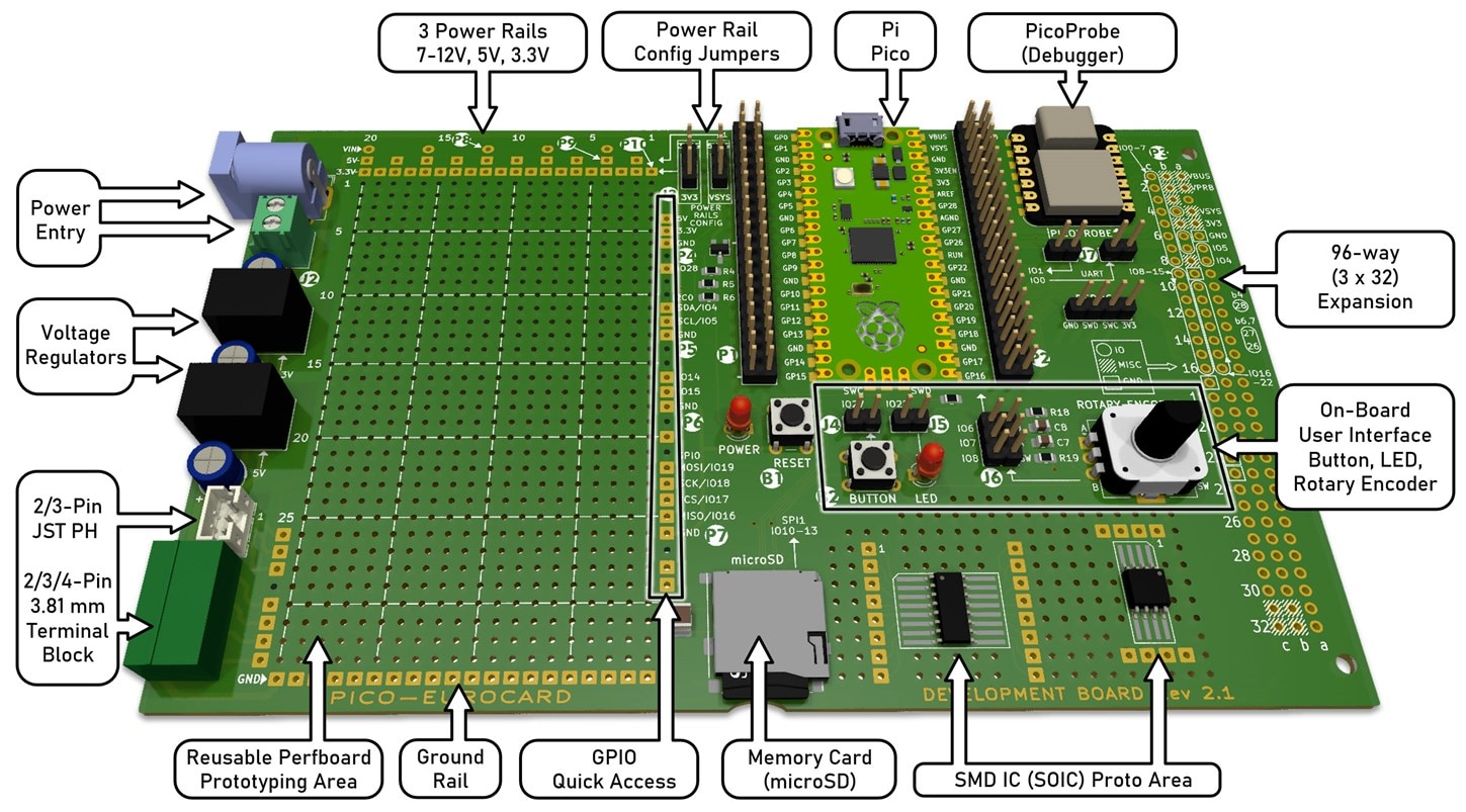

    opiniated: shabaz PICO-EUROCARD Development Board.

    0 shabaz over 3 years ago
    Hi Sean,
    I'm biased too, but if you want the DIY option, then in https://github.com/shabaz123/pico-eurocard there is a zip file there called exportpico_euro_v_2_0.zip.
    If that file is sent to a PCB factory, then the board that arrives can be used as-is (apart from buying the Pico), since the Pico is very complete.
    In other words, by just soldering on the Pi Pico (either directly or with header pins), then the board can be used to patch wires to external breadboard, or to the perfboard area already on the PCB.
    Then, whenever you feel like it, additional parts can be soldered on depending on needs. For instance, a couple of buttons and LEDs, or a 3.3V or 5V regulator, if you want to power other things too.
    This is the completely populated board (but as mentioned, you could start with just the Pico soldered on). The board has space for two Picos (thanks to an idea from Jan Cumps  ). The second Pico is a smaller XIAO RP2040 (it is just used as a debugger when C/C++ coding using the Pico SDK. If you're using Arduino or Python, then it's not required.
    • Vote Up +5 Vote Down

    0 shabaz over 3 years ago in reply to ntewinkel
    I wish/hope they can but I don't know who to ask. Since not everyone will want 5-10 boards from a PCB manufacturer and the associated shipping costs from China, it would be useful for people to buy just one or two.
    I quite like the large size, since it has the built-in debugger and power supplies. Kind of all-in-one for projects.
    The one that Gough Lui links is interesting too, I just noticed they have LEDs on all ports which is pretty neat. I was just thinking, there is a cheaper way to do that using a different method on the Pico-Euro board. On the right side of the Pico-Euro board, the outputs are ordered on consecutive pins, since this is useful for PIO projects (PIO benefits from ordered pins). It is easy to connect a logic analyzer on banks of pins, but there could also be a plug-on custom PCB with LEDs on it (e.g. 8 LEDs), that can be removed and connected to different banks of 8 pins when desired. Far lower cost to do that than having dozens of MOSFETs and LEDs soldered.
