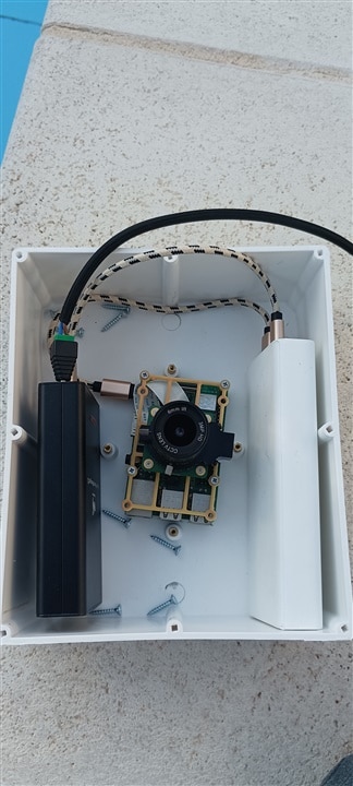

Hi all.
Following a project - AllSky - taking photos all night at the sky - I want to place the PI - Raspberry PI 4 B+ 4GB memory using a SSD NVMe 512GB  - where I don't have a power outlet.
I've the following setup:
- Solar Panel -
  • max power: 20W
  • Vmpp: 18.2V
  • Voc: 22.6V
  • Impp: 1.12A
  • short-circuit: 1.18A
That connects to a Waveshare Solar Power Manager (C), that is powered by 3x 18650 batteries - each battery has 3350mAh - NCR18650B.
I've set the setup voltage switch for 12V - the same as the solar panel.
I don't have a problem with the charging. It charges very well, to full charge.
My problem is, it just wont last all night.
Starting to take pictures at 21:30 (9pm), it only lasts to (the last picture taken) 3:44 (3:44am) . Just over 6h.. This can't be right.
My question is - what can I do to make it last longer. Should I buy more powerful batteries - like 5000mAh or more ? Chose other solar charger ?
I have the Raspberry PI Lite version - and I've disabled some unwanted services like - bluetooth, avahi-daemon, triggerhappy, etc.. I even disabled the status LEDS... Slight smile
Any idea would be great.
Thank you

    So, here's where I'm at so far.
    Even changing to a RPi B+ and using an SDCard, it kept only lasting about 6h.
    Last night, I made a change.
    I know for a fact that, that a 10.000 mAh power bank lasts all night and still has power left - Using a RPI 4 and an SSD .
    But this would imply that I had to disconnect it to recharge. So, I've connected the solar charger to the power bank (to charge it) and the power bank connects to the RPi, like in the picture:
    As of this morning, it was still connected.I just tried to open the webpage of the AllSky software and it was loading and I could see the time lapse from last night. I haven't check the charge of the power bank - but I will assume that the solar charger was depleted - last night, around 11pm I went to check and the last led (it has 4 to indicate the charge) was blinking.. I would assume it was odd, but I know that the power bank wasn't fully charge, so it could have been to charge the power bank to the max.
    I haven't been home since this morning, but the solar panel should be charging the solar charger and thus charging the power bank and RPi should still be on - When I arrive home will see if this is the case.
    I've already ordered some 12.000mAh 18650 batteries to use in the solar charger so I can ditch the power bank (I'm hoping) .
    Best regards
