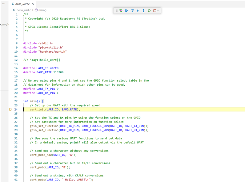

I purchased 2 Raspberry Pico 2W. To try the RISCs.
The 3 things that I want to get going first:

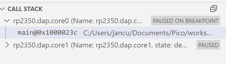

  • White check mark debug session on 1 RISC with PicoProbe
  • White check mark FreeRTOS SMP running on the 2 RISCS
  • White check mark use 3 PIOs (I used the 3rd pio with the stepper motor design I made earlier)

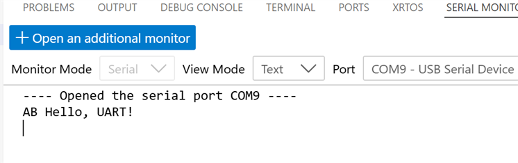

    so it works when I build for the ARM cores on the Pico 2:
    At least I know now that the debugger works, openocd works, and that the Pico 2 works.
    Jan Cumps over 1 year ago in reply to BigG
    Fixed, thanks to BigG  and AI!

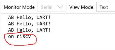

    I did a first little assembler test - code suggested by chatGPT: How to check if a RISCV core is used:
    bool is_riscv(void) {
      uint32_t misa;
      // Try to read RISC-V misa register
      // Only valid on RISC-V. Undefined on ARM.
      __asm__ volatile (
        "csrr %0, misa"
        : "=r"(misa)
        : // No clobbers
      // misa should have non-zero value if this is a RISC-V core
      return misa != 0;
    Then tested it:
        if (is_riscv()) {
            uart_puts(UART_ID, "on riscv\n");
    Result:

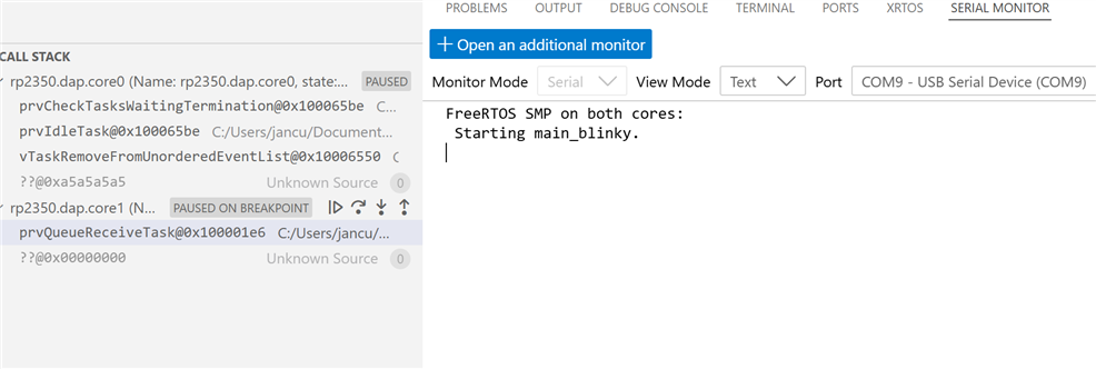

    Some more progress. Goal 2 unlocked:
    FreeRTOS executing tasks on the two riscv cores:

    Jan Cumps over 1 year ago in reply to battlecoder
    The nice part was that I didn't have to change code. Only the build file needed 2 changes (both managed by the VSCode Extension for Pico):
    set(toolchainVersion RISCV_RPI_2_0_0_5)
    set(PICO_BOARD pico2 CACHE STRING "Board type")
    VSCode project:
    pico2_risk_freertos.zip
    No FreeRTOS install needed. It will be fetched by the CMake script.

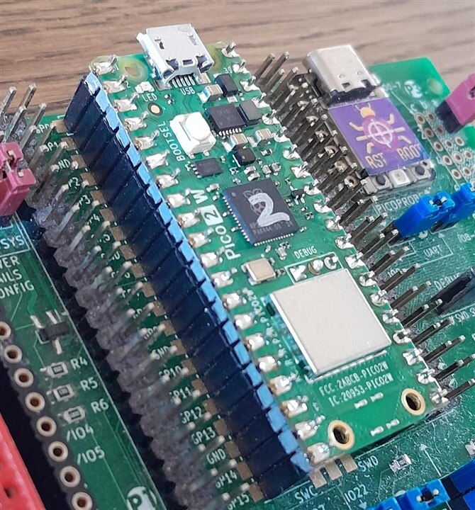

    I ran out of pcb headers for these boards. I went a bit fancy :).

    misaz over 1 year ago in reply to Jan Cumps
    I also bought these on Aliexpress once, but they are pretty brittle. Plastic is absolutely not thermal resistant, so solder them with care and plating layer is not largest as well.
    Jan Cumps over 1 year ago in reply to misaz
    I use a silver paint pen at the moment to mark particular boards or pins. Maybe I should invest in a set of different colours. And paint the trusted black headers.
