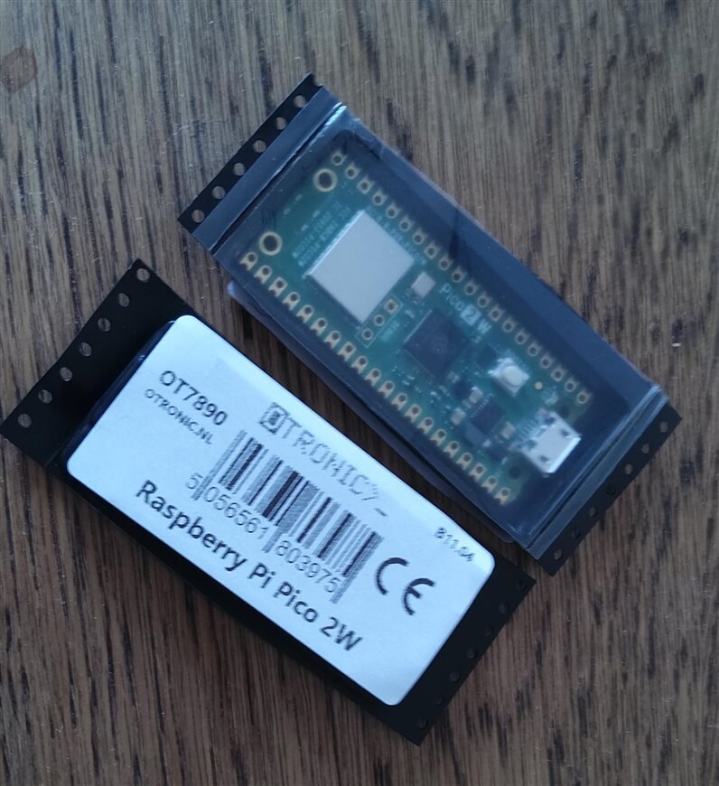

I purchased 2 Raspberry Pico 2W. To try the RISCs.

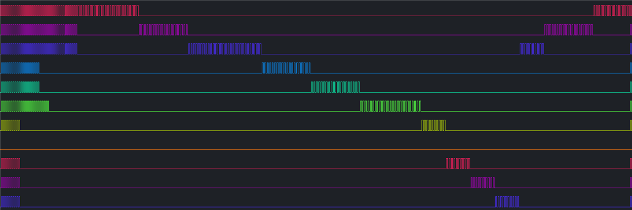

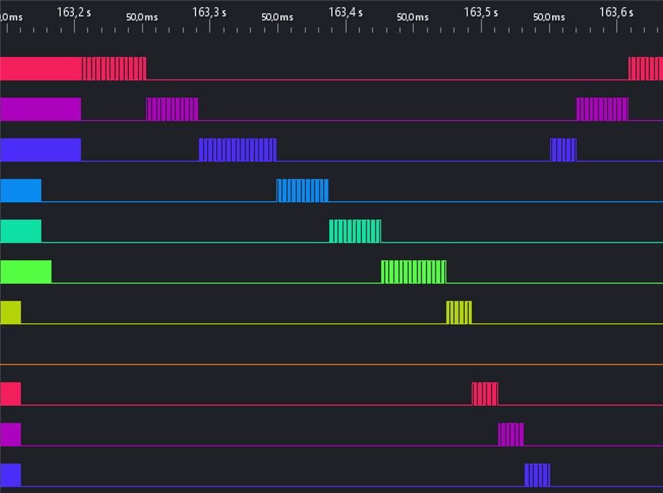

  • White check mark use 3 PIOs (I used the 3rd pio with the stepper motor design I made earlier)

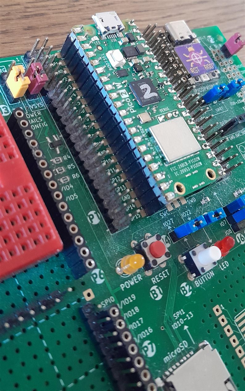

customer action photo: Pico 2W on a pico-eurocard
customer action photo: Pico 2W runs 10 stepper motors on 3 PIOs
