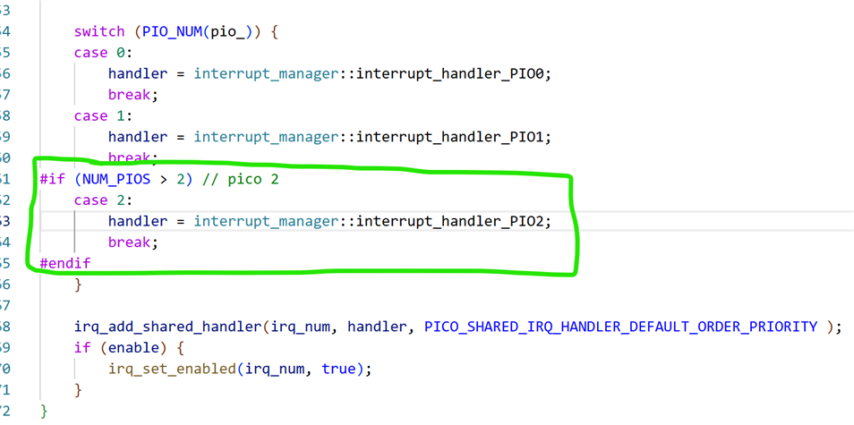

    I got around to using the extra PIO that's available on the pico2. All worked well, including the interrupt handler.
    I'm using a relative PIO interrupt, and the logic to use that is a bit involved. The interrupt number you get in the handler, is a calculated value. That calculation uses the PIO number.
    The calculation isn't complex, but it took a lot of debugging to translate what the Pico documentation says to what really happens.
    I had written the code with pio2 compatibility in mind, but didn't have a board to test it with.
    So now I tested it, and it works.

    Note for developers (and self). By default, the SDK restricts you to 4 shared IRQ handlers. I need to share 10. You can extend the number of shared handlers (at a -low- cost) in the make file:
    add_compile_definitions(PICO_MAX_SHARED_IRQ_HANDLERS=10)
