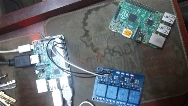

I want to run DC motors with raspberry pi 3 using relay can any one please give me the code ?

    I use 12V power source for relay and this is not the connection. I want to know is the code is correct?  The code I use given bellow.
    import RPi.GPIO as gpio
    import time
    import sys
    import Tkinter as tk
    def init():
        gpio.setmode(gpio.BOARD)
        gpio.setup(7, gpio.OUT)
        gpio.setup(11, gpio.OUT)
        gpio.setup(13, gpio.OUT)
        gpio.setup(15, gpio.OUT)
    def forward(tf):
        gpio.output(7, gpio.HIGH)
        gpio.output(11, gpio.LOW)
        gpio.output(13, gpio.HIGH)
        gpio.output(15, gpio.LOW)
        time.sleep(tf)
        gpio.cleanup()
    def reverse(tf):
        gpio.output(7, gpio.LOW)
        gpio.output(11, gpio.HIGH)
        gpio.output(13, gpio.LOW)
        gpio.output(15, gpio.HIGH)
        time.sleep(tf)
        gpio.cleanup()
    def turn_left(tf):
        gpio.setup(7, True)
        gpio.setup(11, True)
        gpio.setup(13, True)
        gpio.setup(15, False)
        time.sleep(tf)
        gpio.cleanup()
    def turn_right(tf):
        gpio.setup(7, False)
        gpio.setup(13, False)
        time.sleep(tf)
        gpio.cleanup()
    def pivot_left(tf):
        gpio.setup(7, True)
        gpio.setup(11, False)
        time.sleep(tf)
        gpio.cleanup()
    def pivot_right(tf):
        gpio.setup(15, True)
        time.sleep(tf)
        gpio.cleanup()
    def key_input(event):
        init()
        print 'key:', event.char
        key_press = event.char
        sleep_time = 0.001
        if key_press.lower() =='w':
            forward(sleep_time)
        elif key_press.lower() =='s':
            reverse(sleep_time)
        elif key_press.lower() =='a':
            turn_left(sleep_time)
        elif key_press.lower() =='d':
            turn_right(sleep_time)
        elif key_press.lower() =='q':
            pivot_left(sleep_time)
        elif key_press.lower() =='e':
            pivot_right(sleep_time)
        else :
            print "try again "
    command = tk.Tk()
    command.bind('<KeyPress>', key_input)
    command.mainloop()

    Hi Samir,
    That is a much better post, thank you.
    Sorry I don't code for the PI myself, but it looks wonky (anyone else?)
    Why are forward and reverse coded differently than  the turns and pivots?
    Are you using 2 motors or 4?
    Are those solid state relays or mechanical?
    Why does it look like your are running the GPIO pins as if you had direct motor hookup; when you are using a relay board?
    So you have control of IO pins, and your relay has a power amplifier already.

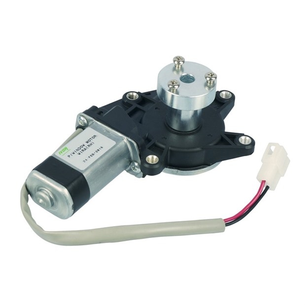

    What are you using as a power supply for the motor? Those window motors tend to draw a lot of amps. I have a slightly larger one that will pull up to 20 amps locked rotor.
    If you are going to drive 4 of them you will need a pretty stout power supply.
    Take a moment and walk me through your code and what you are expecting it to do.
