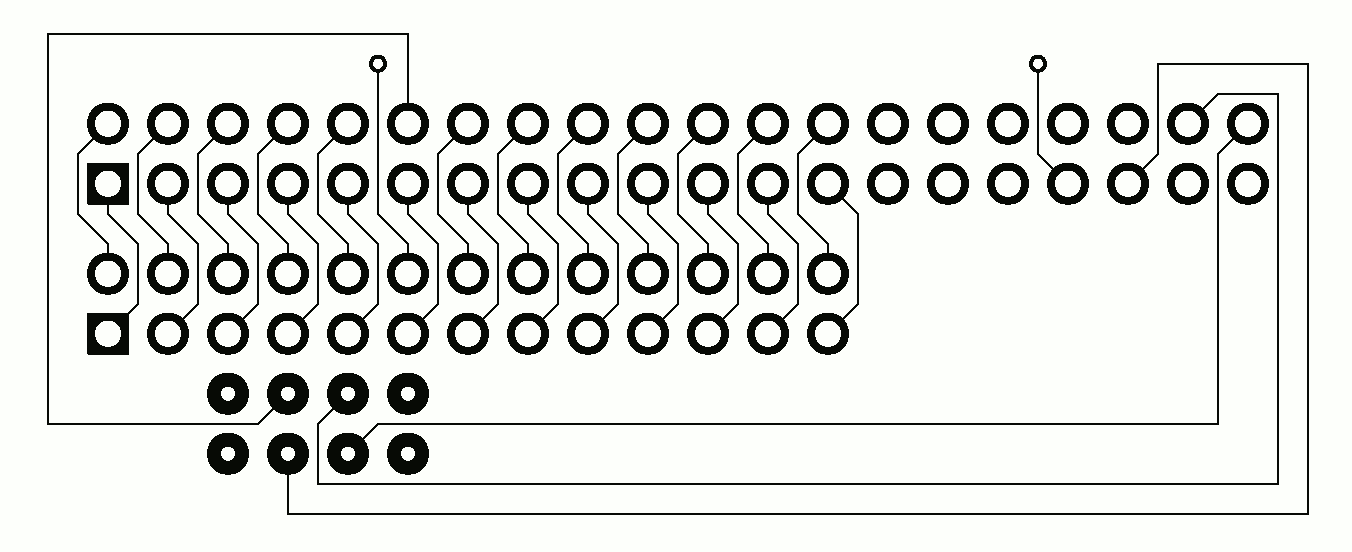

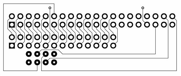

    psyj over 8 years ago in reply to psyj

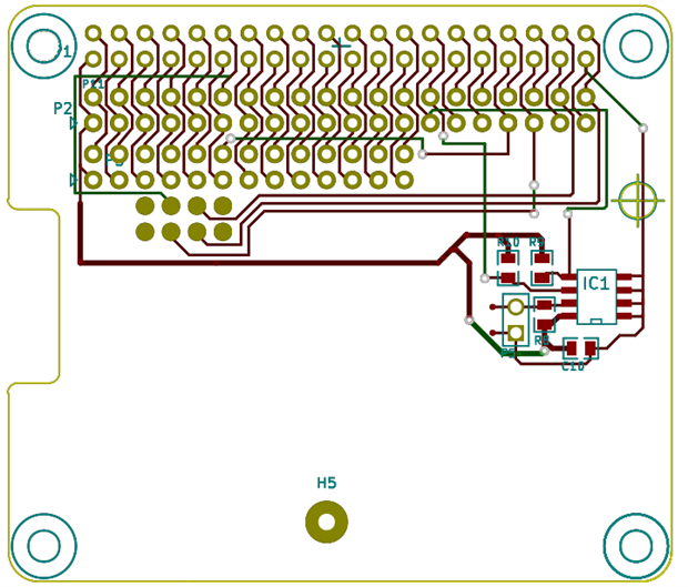

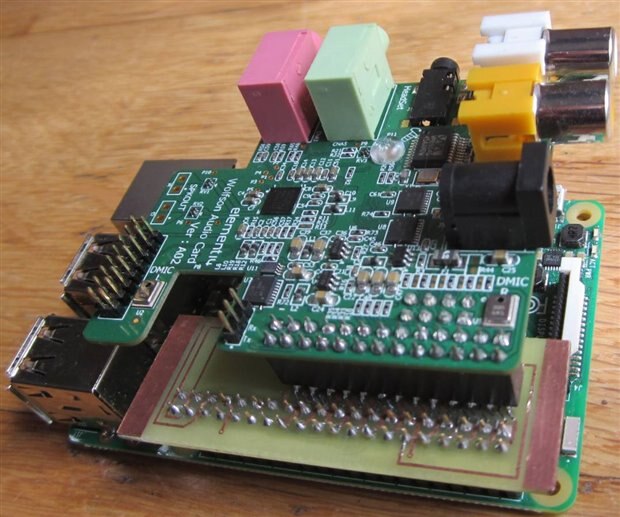

    All,
    I promised an update on the piggy back card approach. Apologies for the delay, real world demands ...
    First a photo
    Herewith my observations
    1)  Making the pcb at home is a pain for the following reasons.
    1.     Drilling the board exactly (for the headers) is difficult.
    2.      I can do only single sided boards and this approach demands "creativity" when installing the 26 pin header for the Wolfson. Plated through holes would be better/easier/stronger
    3.     (and worst) the pads to receive the pogo connectors must be gold plated (So whilst my card works at the moment, I await the effects of O2)
    So the board needs to be made professionally to be a good long term option  .... and that will mean 10 of them!
    2) The Wolfson is well clear of the main board.  This is good for ventilation and for access to the ribbon cable connectors if you need them. It is bad in terms of mechanical support of the card.
    3) It does offer a zero mod way of connecting the Wolfson to a pi 2/3
    Overall I shall probably "sacrifice" a pi 3 and cut pin 12 off the Pi header and connect Wolfson direct to pi 3, ie not bother with a piggy back board .  It is a minor mod and will have probably no impact on any future project  ... and a pi is easier to source than these sound cards!  So, with the exception of not removing R39, I will probably follow the same route as others on the forum.   But if your project needs easy access to those ribbon sockets, the piggy back route is worth considering.
    Good job I am a Brit (expat) and still have one of those mains plug shrouds!

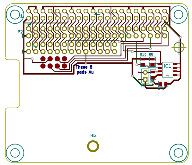

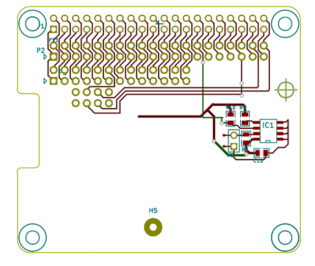

  • hystrix
    hystrix over 8 years ago in reply to psyj
    Nice PCB!  If you are taking orders for a professionally made piggy-back board, put me down for one image.

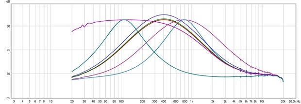

    Bad form replying to my own post, but I have started playing with the EQ filter parameters, guided by WISCE.  herewith some results
    The curves here are not particularly important. what is important is that WISCE only allows certain, heavily quantised frequencies, all of them above 100Hz.  The purple curve might give a clue why,  I think that (for obvious reasons) it is seeking to have zero gain at 0Hz.  Well that is all sensible, but when I try to "ski off piste" by putting raw values into amixer set commands (nothing extreme, just shifting the frequencies slightly) the linux driver throws me out with an "invalid parameter" warning. So not only WISCE , but ALSA as well are doing parameter checking.  So in answer to your earlier question, it would seem the only way to use other parameters is by direct register access via i2c   ....... accepting of course the risks involved!
    (Postscript:  any idea where the parameter checking is done?    ...... .with a bit of generous help from A.N.Other it is done in arizona.c  . which fails all A and B parameters whose absolute value exceeds 4095 and also does a ratio check between A and B)

    Thanks a lot for the WM5102/8804 setup files, but I did get the same error(s) as before. When using the WM8804 I also got the DLL error - which seems to be the root cause for both WM5102 and WM8804 failing. I'll leave it there, no interest in entering the windows DLL rabbit hole (after all it could be caused by using Windows XP).
    As for the filter coefficients: the wm5102 driver has been written by Wolfson/Cirrus so I'd guess they put the checks in there for a reason image
    The datasheet indicates that the allowed filter cuefficients depend on sysclk which is either ~49MHz (when using 32/48/... kHz) or ~45MHz (at 44.1/88.4/... kHz) - so the actual samplerate shouldn't have be a huge issue. Anyways, you can check the current audio device playback settings via /proc/asound/card0/pcm0p/sub0/hw_params (or pcm0c for capture/recording).

    OK, to close off my thinking on the equalisation blocks.  Finding the parameter checking in the driver (the bit provided by Wolfson in arizona.c) has revealed a lot about the parameters you should pass to the equalisation blocks in the Wolfson.
    The checking is exactly that needed to check for stability in second order biquad filters and corresponds perfectly with the checking done by the WISCE software.
    No big suprises there.
    But what that means is that if the WISCE software will not let you have a certain set of parameters, it is for good reason and no amount of bit tinkering elsewhere will give you extra functionality from the WM5102.  Worse, you will have unstable filters.  I have for example verified that (at 44100) the first three frequency bands you can have are 110 156 and 191Hz.  Not only does this show from the WISCE software, it corresponds exactly with the quantisation of the a1, a2 parameters in a biquad filter  ...... 1+a1+a2= 1/4096,2/4096,3/4096 (read www.st.com/resource/en/application_note/cd00222512.pdf if you want.  It is the least mathematical explanation I can find, and predicts perfectly filter frequencies)
    So what does all that mean.  Basically that you cannot have accurate low frequency band pass /cut filters with the Wolfson. I would suggest that the accuracy becomes sufficiently good at 300Hz and above for 44100 data( the first 10 bands are 110, 156, 191, 221, 247, 270, 292, 312, 331, 349 HZ, shifting a bit depending on Q).  And the situation is in reality worse for higher sampling rates (the band frequencies are those I have mentioned multiplied by the ratio of the sample rates, so at 88.2 the bands are at twice the frequency) .
    So the EQ units can be used effectively as tone controls but not as an effective DRC (digital room correction) for the sized rooms I live in. The Low/High pass filters are much more useful with set points only 2-3Hz apart.
    I guess that is already more than enough, but if anybody needs further details, I am happy to provide.
    (postscript .... and the parameter for the low/high pass filters on the Wolfson follows perfectly the same maths, that is to say (quoting the above source)
