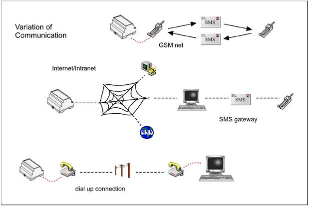

    geralds over 9 years ago
    Hi,
    As explained by others, this is an old technique.
    We have used a long-range modem with 2.4kbd.
    The call ID must be enabled by the service provider, then the ID can also be received.
    The transmitter, the remote system, has inserted the ID in the software and sends it together with the status protocol.
    The receiver, the stationary system, now identifies with the ID, which transmitter transmits its states.
    This data is then evaluated in the software of the plant.
    Today, the Internet is normally used with the WAN-LAN interface; Gateway, or Router.
    With the analog modem the data with this protocol are used.
    The hardware of the local system can also have a LAN modem connection.
    Then you have to connect the modem to a virtual LAN-COM port.
    This virtual COM port can be easily set up in the operating system.
    All necessary programs for the connection are available in the operating system and the application of the local system accesses these interfaces.
    With your Visual Studio you can write your own application software.
