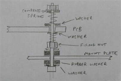

Hi all,
I'm working on a project at the moment where the Raspberry Pi 3b and Zero (both in the same box doing different functions) are in a hostile environment.
The best example would be... imagine it was attached to a small shipping container where it is constantly picked up by a forklift, put down violently, dropped, banged into, etc.
There are a lot of variables, but the only one I am worried about at the moment is the Pi's themselves in the box that will be attached.
What is the best way to mount them, or material to surround them with that would best protect them from being destroyed quickly?
Thanks for the help guys.

    dougw over 8 years ago
    Strong cases made of polycarbonate, aluminum or die-cast metal are a good start, but the case also should be mounted on shock mounts or foam to minimize shock loading. And make sure all cables have adequate strain relief.

  • rew
    rew over 8 years ago in reply to DAB
    If there is any flexibility at all, you will get things breaking off due to the moment of inertial. Even small things.
    If you have a rigid box and drop it from 10cm, and the floor does not give in so that the box stops inside a stopping distance of about 0.1mm, then the G-force experienced by the box (and everything rigidly attached) is going to be 1000G's. Having say 1cm of "cushion" is going to reduce the G-loads enormously.
    So for stuff that is shipped and might be dropped once, they use Styrofoam. It crushes and absorbs energy when under a high load. For stuff like "hard disks" inside a "ruggedized" enclosure, you see rubber used as a cushioning material.

    14rhb over 8 years ago
    Skeeve,
    For a diy approach you could shock mount the RPi3 and PiZero to a small metal plate (eg aluminium). Use 2.5mm machine screws, rubber tap washers/grommets, suitable metal washers and light duty compression springs. You'd have a mounting that had some dampening in the plane parallel to your pcb as well as perpendicular. Adjusting the nuts (suitably threadlocked) to give just the right amount of restraint.
    Like this:
    Rod
