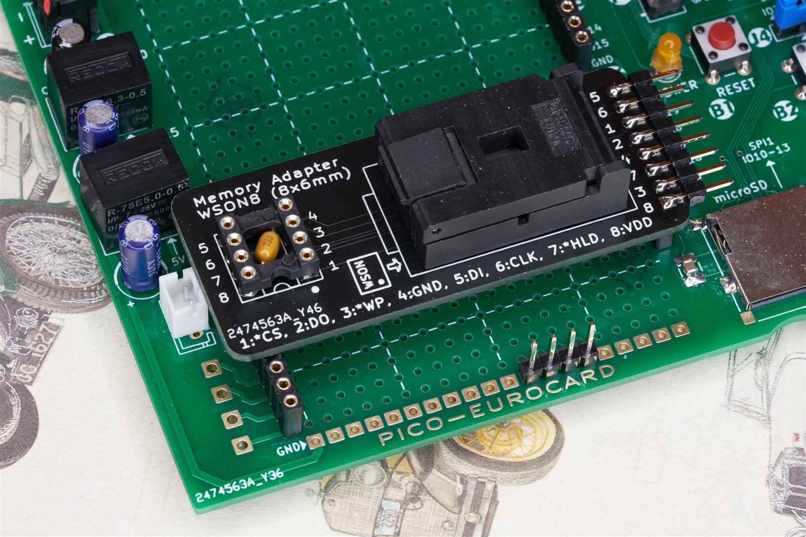

Due to the component shortage, one might be forced to use surface-mount memory parts, but fortunately, the 8 pads are very widely spaced usually, and so they are quite easy to hand-solder.
You can also get flip-top sockets for them if you’re planning to program a lot of chips of a specific size. I got such a socket from AliExpress.
Photo of a few memory chips for size comparison (they can be a lot smaller! but these sizes are easy to hand-solder):
The bottom of the blog post has downloadable files for a test board for 8x6mm WSON-8 chips.
They are pretty large for SMD packages, with 1.27 mm spaced pads, so a socket isn’t essential if you’re just experimenting. The particular memory chip I used for testing was MX25L12833FZ2I-10G
The SIL header pins on the right side can directly plug into the Pico Eurocard, or you could just use jumper wires to connect it to any microcontroller board.
