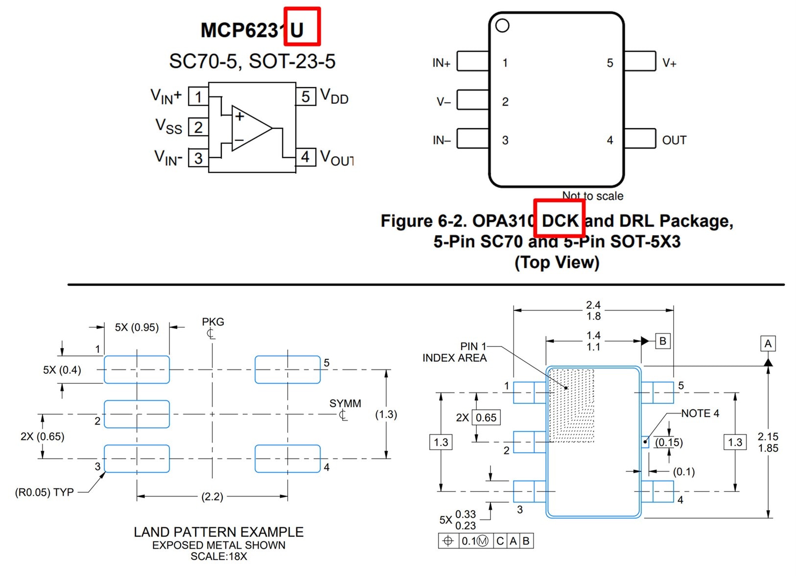

    shabaz over 1 year ago in reply to ggabe
    For the prototype for now I used what I consider to be "jellybean" resistors nowadays, i.e. 1% 100ppm thick film (I have these at hand without needing to order anything special), and the board has large 0805 pads, which will allow 0603 and 0805 sized parts to fit equally well, and possibly 0402 at a pinch (I could modify the pads for making that easier).
    For the ADC package, it is a standard 14-pin layout for quad op-amps so it is easy to swap for a better part. The TS9924 has a very sparse datasheet, it's just a low-cost but reasonable part, especially if there's no desire to use beyond a typical room temperature, i.e. just calibrated and used at the approximate temperature in a home.
    For a nicer part with more defined behavior, perhaps it's best to change the layout for the next revision to use a dual op-amp, since then there's a wider selection. It may push the cost up a bit more, but I think there can still be low-cost options with the dual op-amp.
    The smallest OPA2325 package (VSSOP) won't save a lot of space compared to the current quad op-amp package, so I'll have to find a single op-amp that is a lot smaller. Maybe there are easy-to-solder QFN single op-amps, it doesn't need to be special.
    shabaz over 1 year ago in reply to shabaz
    (Can't edit).
    SC70 is suitably annoyingly small, so I'll go with this package and pin arrangement (there are several arrangements but this seems most common across more than one manufacturer) for the single op-amp.
    (can't edit). i.e., for the next revision, I'll use VSSOP for the dual package, and SC70 for the single package, since I need a total of 3 op-amps. It's all approximately the same cost as the quad-op-amp, so it's still very low cost.
