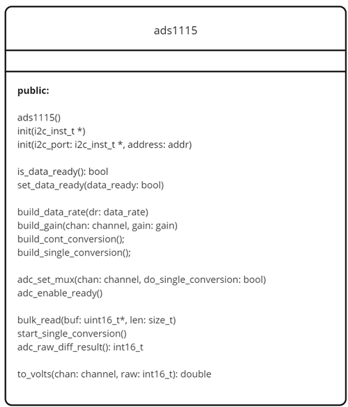

ads1115 class
I've designed it as an OO API for the Data Acquisition Board for Pi Pico. It's able to handle one ADC, configured for differential input.

These members only change the object state. There's no communication with the ADC at all.
action, sample
These members talk to the IC. Registers are set, multiplexer configured, Ready pin behaviour set up, samples taken.

The Code
You'll find a link to the Github repository at the end of this post. The repo is a clone of Shabaz' code for the daq. I created a new branch for the OO version. That repo has a CMake file and can be built in the same way as the Pico examples from the Pico C/C++ SDK.
class header
#ifndef _ADS1115_H_

public:
    ads1115() : data_ready(false), i2c_port(nullptr), address(addr::A_LAST), dr(data_rate::DR_860) {}
    bool init(i2c_inst_t *i2c_port); // configure for first found IC
    bool init(i2c_inst_t *i2c_port, addr address); // configure for IC with provided address
    inline bool is_data_ready() {return data_ready;}
    inline void set_data_ready(bool data_ready) {this->data_ready = data_ready;}
    void build_data_rate(data_rate dr);
    void build_gain(channel chan, gain gain);
    void build_cont_conversion();
    void build_single_conversion();
    void adc_set_mux(channel chan, bool do_single_conversion);
    void adc_enable_ready();
    void bulk_read(uint16_t* buf, size_t len);
    void start_single_conversion();
    uint16_t adc_raw_diff_result();
    // convert the raw value to volts present at the ADC input
    // adjust for opamp gain
    inline double to_volts(channel chan, uint16_t raw) {
        return (double)(((int16_t)raw) * (adc_range[(uint8_t)chan] / 32768.0)) / opamp_gain[(uint8_t)chan];
#endif // _ADS1115_H_
