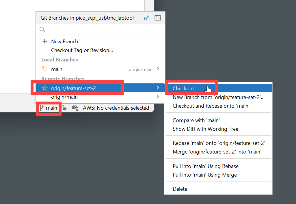

If you look closely at the bottom-right of the CLion interactive development environment (IDE), you’ll see you are on the main branch. Visual Studio Code shows it in a similar way, but on the bottom-left side; see the earlier blog post to see the detail.

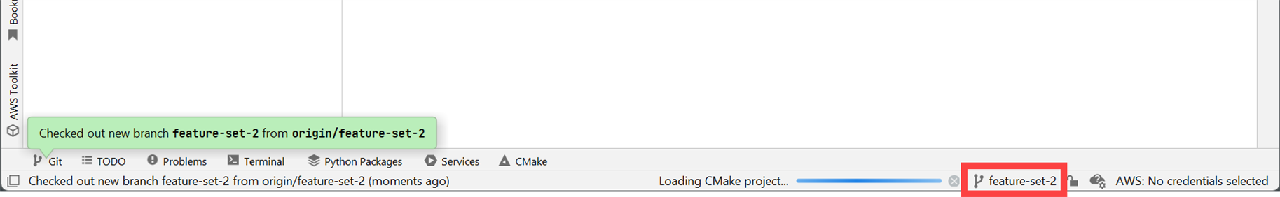

If you click on that, you can select a different branch. As mentioned, we are interested in the latest development branch that Jan has created (and which is in your fork of the repo), since that is a candidate for future merging by Jan into the main branch. If you want to add a new feature, then it’s best to look for that development branch, and it will have more recent features in it that the main branch does not.
In the screenshot below, I selected the development branch called feature-set-2 and selected Checkout.
You’ll see a green success pop-up appear, and now you’ll see that the correct feature branch is selected at the bottom-right, and now if you build the code, you’ll have all the features from that branch.
Note that if you ever need to update the content from the feature branch (for instance, if Jan adds some new features) you can click on the Update arrow icon as shown in the screenshot below; it is part of the Git Toolbar in CLion.
The screenshot above shows that Jan made some changes at 14:29 and 14:28, and they will now be on your local PC.

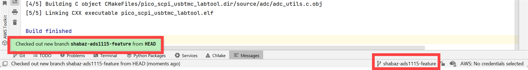

Now that you’ve switched to the development branch, you can create your own branch off it, known as a feature branch, specifically for developing your feature. The new branch will be just local to your PC, but eventually, you’ll publish it to the cloud. Go to Git->New Branch and give it a name, such as (in my case) shabaz-ads1115-feature. Make sure that Checkout Branch is checked, as shown in the screenshot below, and then click on Create.
You should see a green success message appear at the bottom of the window:

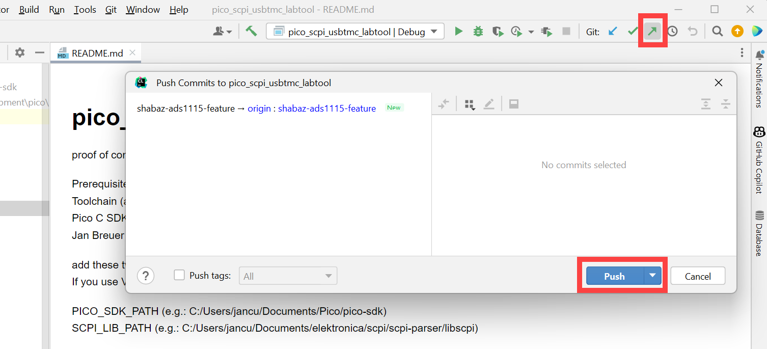

Update the Cloud Repository with your Feature Branch

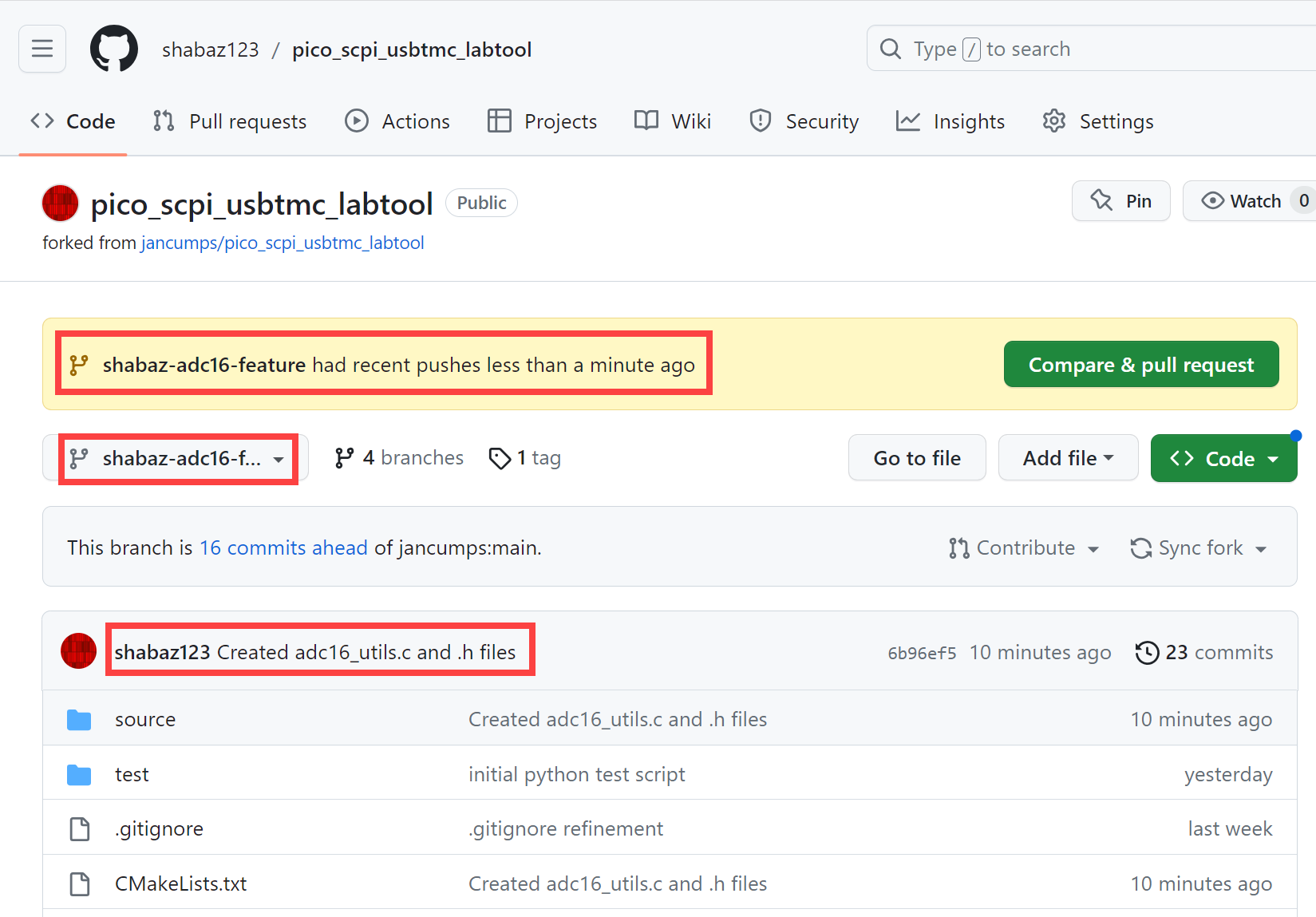

It’s a good idea to immediately publish the information that you’ve created a local branch so that others know what you’re working on. This is easy to do with CLion. Simply click on the Push icon.

After you click on Add in the pop-up window, you’ll see that the new files are displayed in green in the project explorer, rather than black. You don’t have to do it immediately (you may wish to add some code to the files first) but to make them black, right-click on the files and select Git->Add, and then once you’ve done that for both of them, then click on the Commit icon.
In the window that will appear, type a description (for instance your text could be Created new source and header files) and then click on the button labelled Commit. Now your local copy of the code will be appropriately labelled that the new files are part of the project, and they will turn black.

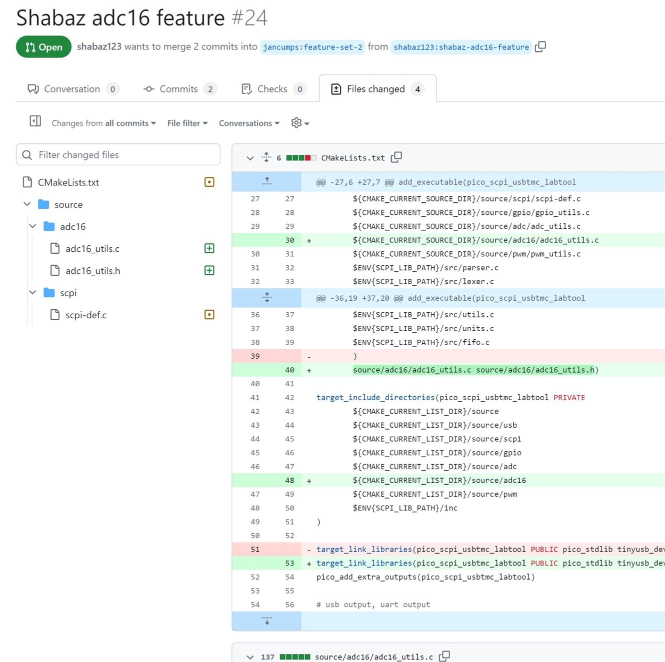

Modifying the CMakeLists.txt File
The CMakeLists.txt file will need to be modified. Here are the three most likely things that you’ll need to consider:
1. If you’re using any Pico SDK functionality that isn’t already being used by the project, then you’ll need to add to the target_link_libraries section. In my case, I needed to add hardware_i2c since that’s what my feature needs.
2. If you created a new folder and it contains a header file, then you’ll need to add it to the target_include_directories list. I added the following entry:
${CMAKE_CURRENT_LIST_DIR}/source/adc16
3. If you added a new source file, then you’ll need to add an entry to the add_executable section. I added the following entry:
${CMAKE_CURRENT_SOURCE_DIR}/source/adc16/adc16_utils.c
After you’ve saved the CMakeLists.txt file, click on Reload changes as shown in the screenshot below.

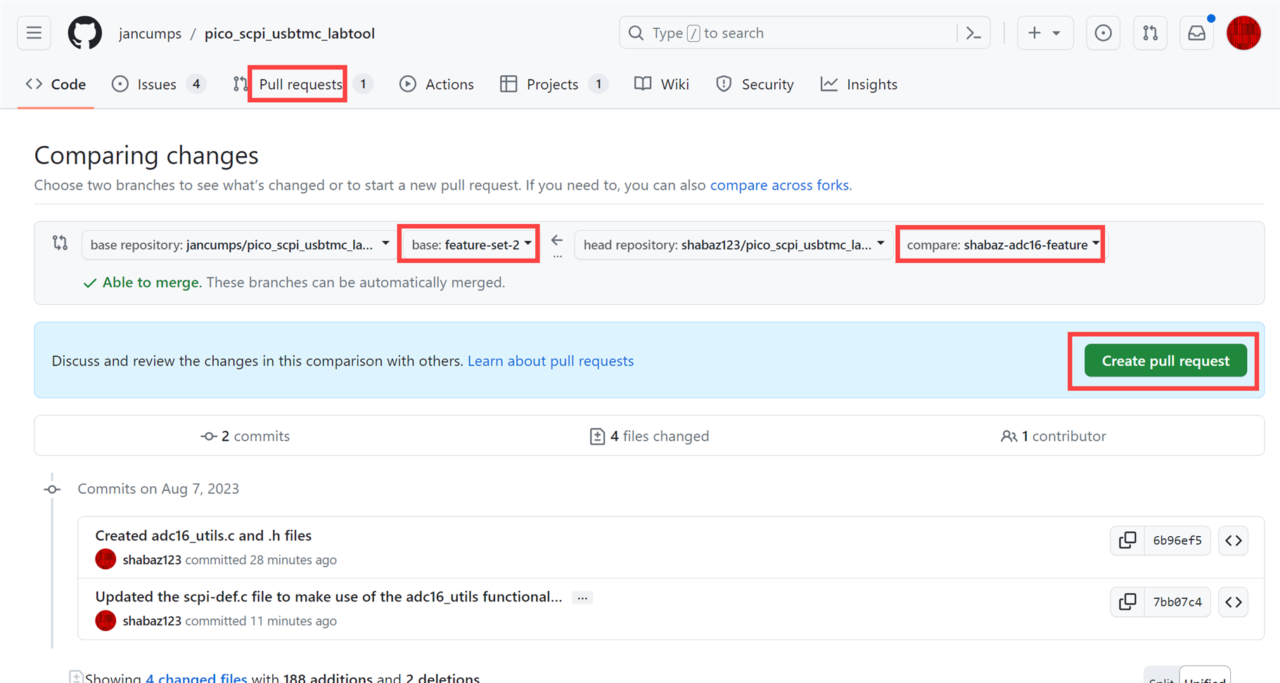

Ready for Review

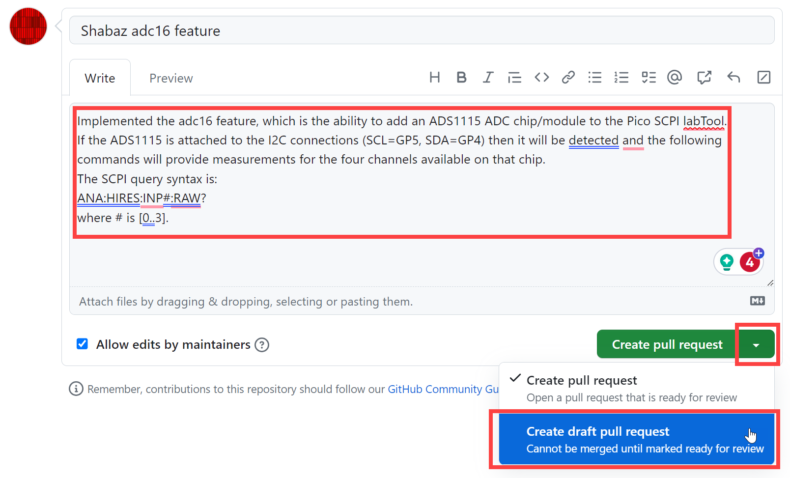

Once you’re happy with your feature code (and you’ve clicked on the Commit and the Push icons regularly, as discussed in the Incremental Development section above, and done it on completion), go to your GitHub repo, and click on the Pull Requests tab, then click on New Pull Request.
The screenshot below shows what needed to be configured. Select from the drop-down boxes the destination and source branches. The destination is the development branch, and the source is your feature branch. Then I clicked on Create pull request.
There will be a drop-down to select Create draft pull request. Write some detailed notes for Jan to understand what you’re requesting to be reviewed and merged:
Finally, further down the page there should be a Ready for Review button. Click on that and then send the page URL to Jan.

At Jan’s end, all the code you’ve created or modified will be visible for review:
If Jan is happy with it, and if there are no conflicts then Jan will click on Merge pull request:

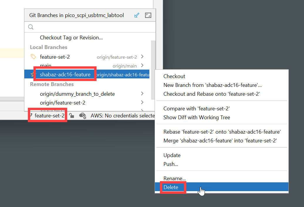

To delete the branch in the repo, go to your GitHub repo and click on branches:
Next, click on the trashcan icon next to the feature branch:
