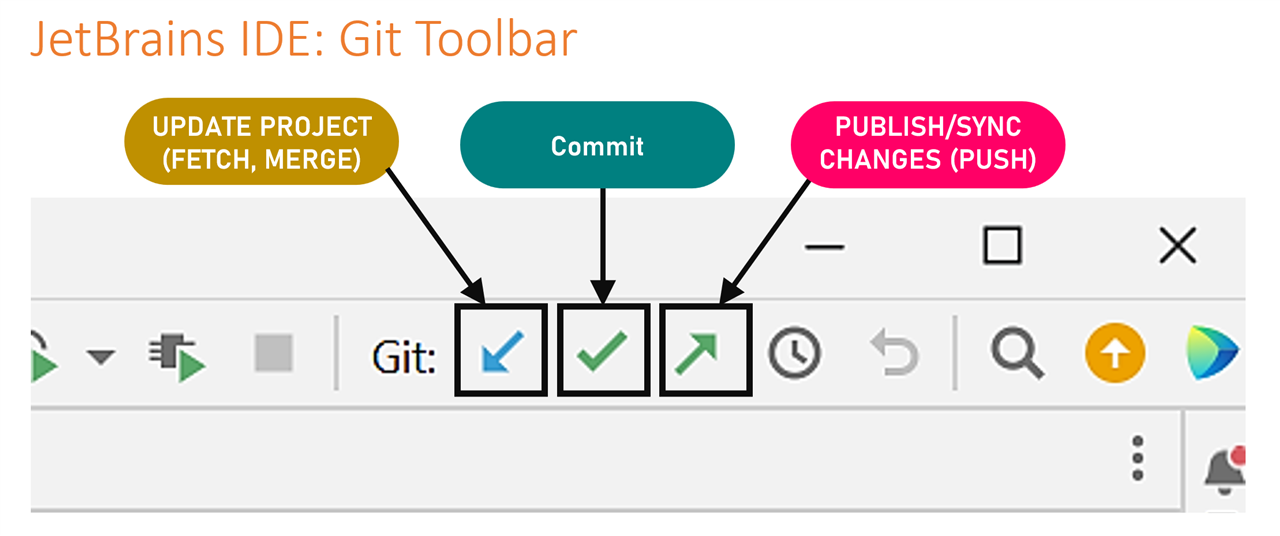

To recap, or if you’ve not read the other blog posts, the IDEs have Git capability. With Jetbrains IDEs such as CLion and PyCharm, the Git Toolbar will often be used:

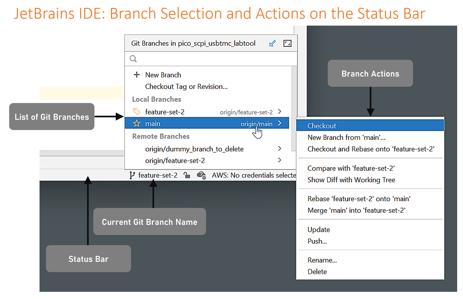

The current branch name, and branch actions, are all available from the status bar at the bottom of the window:

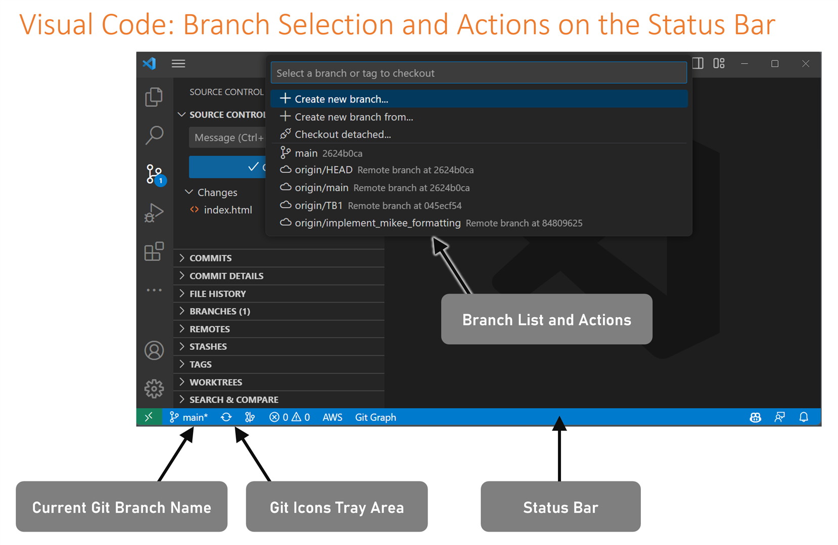

Visual Studio Code

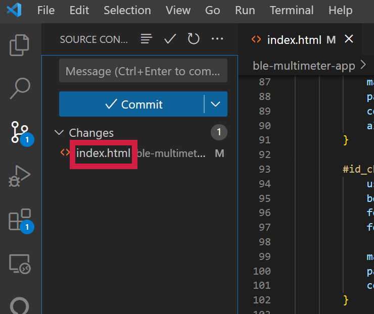

Visual Studio Code also has in-built Git integration, however, I found the optional GitHub Pull Requests and Issues extension to be useful, and it can be installed by clicking on the Extensions icon. The vertical bar (known as the Activity Bar) will have two icons of use for working with GitHub. The Source Control icon is used for many tasks. The GitHub icon is useful for performing some of the final steps during the development process.
As with JetBrains IDEs, the currently selected branch is indicated on the status bar at the bottom of the window, although it will be on the left side of the window rather than the right side.
Clicking on the branch name will display a list of all branches at the top of the window. Some Git related icons will also appear in the status bar, dynamically as they are required.
Using Visual Studio Code for Git related tasks can seem initially a bit more complicated than with JetBrains IDEs unfortunately.

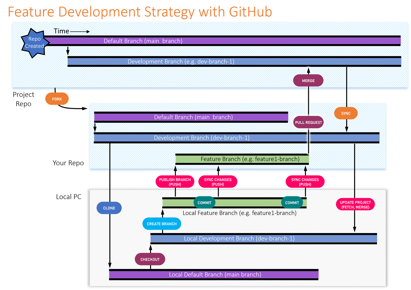

The diagram below shows how things might work out in a good scenario. The horizontal long bars are branches of code, and time runs from left to right in the diagram.
At the top of the diagram, is the project code of interest, sitting in a repository, usually in a cloud of some sort. Often there will be a main branch, with mature, reliable code. In addition there may be one or more development branches, also known as release trains. These are the branches where new functionality resides, as it is developed by engineers, and accepted by the release train engineer (who will be the project repository owner for many open source projects). A development branch may opened up by the project owner, all ready for incorporating some desired features (if you wish to see where you can help out, there may be a list of issues, such as enhancement requests, on the GitHub website for the project).
The diagram shows the main branch, and a single development branch. That development branch is where you’ll want your feature to eventually get into, because then (eventually) the owner (in real life it will be a devops engineer) will merge that into the main branch.
All the steps in this suggested strategy are described below, in the sequence that you’ll be using them, following the path laid out using arrows in the diagram above. You may wish to open up the diagram above in a separate window, so you can follow it alongside the remainder sections in this blog post.

The Feature Branch is where your code is entered. To create the branch on your local PC, you can click on the current branch name at the bottom status bar, and then select (if you’re using Visual Studio Code) Create new Branch, or (with JetBrains IDEs) New Branch.
Give the new branch a descriptive name such as blinking-led-feature if that’s what the new feature does.

As you create the feature, you’ll want to regularly check-point where you’ve got to. To do that, click on Commit in your IDE. With Jetbrains IDEs, that’s the icon that looks like a check-mark, on the Git toolbar. With Visual Studio Code, you’ll use the Source Control icon and select the files containing the changes, and a text box and a Commit button will appear; as part of the commit operation, you definitely ought to type some brief notes to help recall what the code does so far.
You can also then publish your changes to the cloud, by clicking on Push (the same way as described above in the section Publish the Branch (Push). Do it regularly, immediately after the commit.

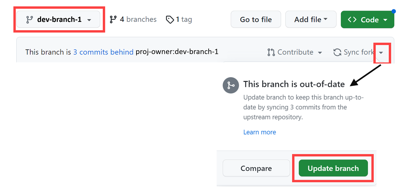

After the feature branch has been merged into the project owner’s development branch, your fork of that branch in your repo will be outdated, as will be the local development branch on the PC. The development branch in your repo can be updated by clicking on the Sync Fork drop-down and then click on Update Branch.
The local development branch can be updated by performing a Fetch and Merge action, which is a single Update Project button in Jetbrains IDEs, available on the Git toolbar. With Visual Studio Code, it will be a Sync circle arrow that will be visible in the status bar at the bottom.

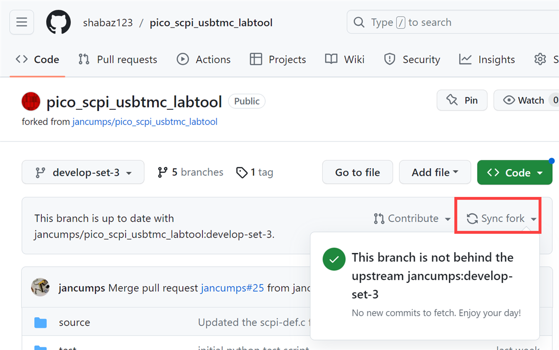

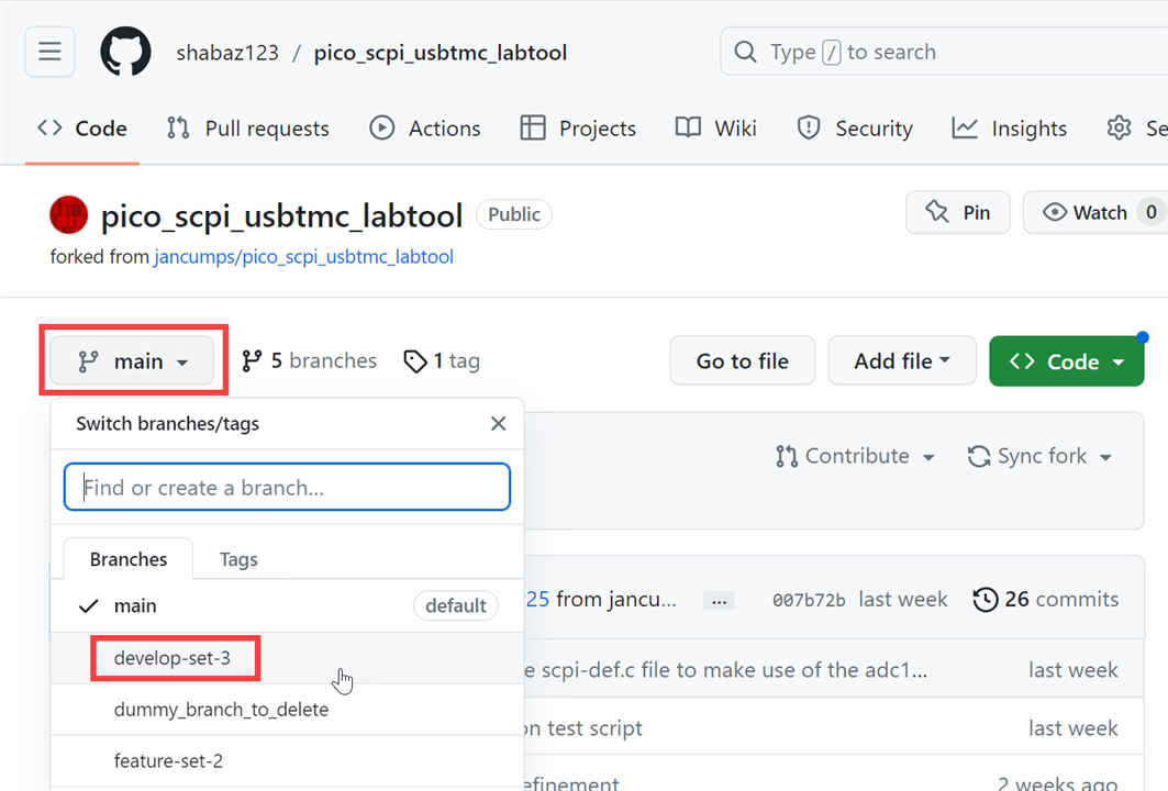

Now you can go to your repo, click on the drop-down containing the branch name, and select the branch:
Now click on Sync fork:

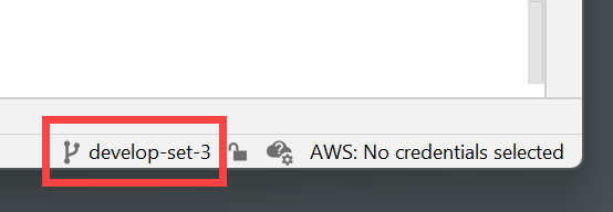

Now go to the IDE, and select the branch (it may already be selected) at the bottom on the status bar:
