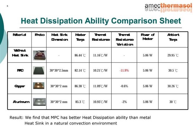

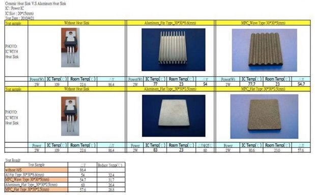

Ceramic heat sinks have an innovative structure (vias or micro-pores) which allow a heightened thermal conductivity compared to traditional aluminium heat sinks. They also can have the advantage that they won't affect radio frequency (RF) communications as much, when positioned close to the wireless antenna that is present on the Pi 3.
Furthermore, ceramic heat sinks are not electrically conductive and therefore there is no risk of accidentally shorting something on the Pi.
Back-of-the-envelope calculations (we don't have all parameters since we don't have a copy of the Broadcom datasheet to examine the device operating conditions in detail, nor a copy of the schematic to examine if we can measure device power consumption isolated from the remainder circuitry) suggests that a heat sink with thermal resistance of around 10 degrees C/W might be effective to keep the Broadcom chip's internal temperature below 120 degrees C when the ambient temperature is below around 40 degrees C. These are guesstimates until practical measurements have been taken.

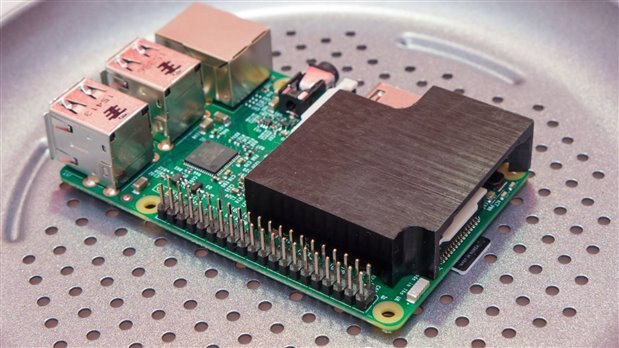

The Broadcom chip is about 14x14mm in size, and ceramic heat sinks do exist in approximately that size. However it is possible to attach a larger heat sink if desired.
The photo below shows the parts that were examined. All of these ceramic heat sinks come with adhesive tape on the underside; the protective tape is removed and the heat sink will stick to the top of the integrated circuit.
The photo at the top of the blog post shows the largest 22x22mm ceramic heatsink.
The photo below shows a heat sink closer to the size of the Broadcom chip, 15x15mm. It also shows a 10x10mm heat sink on top of the USB hub/Ethernet controller chip, however this is really not needed. It doesn't get very hot according to the thermal photos in the previous blog post.
The memory chip on the underside gets hot too. If desired, the 15x15mm heat sink could  be attached there too. The 22x22mm one is too large for that location due to nearby components (the memory chip has a lower height than the Broadcom chip on the top side).
So, I plan to attach a 22x22mm part to the Broadcom chip on the top of the board, and possibly a 15x15mm heat sink to the memory chip on the underside. I don't think a fan will be needed unless a very small enclosure with no natural ventilation was used, or if the Pi was in a very warm environment.

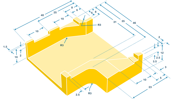

    shabaz over 10 years ago in reply to bwelsby
    Here is a duct design, I only had 12mm plastic otherwise it would have benefited from a higher lip at one end to capture more air from the fan.
    So instead I might use some tape to create an angled interface between the fan and the duct.
    This is what it looks like sitting on the Pi 3 (would need to be clipped/taped or glued in place):
    It is not possible to use one screw hole with this design, it covers it : ( So with this design, that reduces the [practically] usable holes on the Pi down to 2 again (the one near the antenna shouldn't have a metal screw).
    Also I will probably drill a tiny hole at the top for the thermistor wires.
    (The design above is free for use by individuals or education, for non-commercial use only, in case anyone wants to replicate it).
