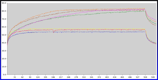

  • bwelsby
    bwelsby over 10 years ago
    Ok here is some data of the tests so far.
    the test enclosure cover off heatsink on fan connected :-
    The test plan:-
    Test#  Fan   Cover    Heatsink   Graph Colour
    1         0        0           0               Brown
    2         x        0           0               Red
    3         0        x           0               Orange
    4         x        x           0               Yellow
    5         0        0           x               Green
    6         x        0           x               Blue
    7         0        x           x               Violet
    8         x        x           x               Grey
    Graph of results. Test # is the same as the standard resistor colour codes image Ambient temperature was 22'C
    I'll let you draw your own conclusions, feel free to ask any questions.
    Brian
    Edit: I should've said the numbers along the bottom are approximate seconds.
    Edit: 8-Mar-16 Oops nobody spotted I had the wrong numbers for test1, corrected the mistake and updated the graph.

    bwelsby over 10 years ago in reply to shabaz
    I received the fans on Saturday and have run some initial tests.
    With and without heatsink
    Again with and without fan blowing  over the SOC
    Again with and without enclosure lid
    I ran the tests using   "stress --cpu 4"
    I have yet to repeat the tests with a HAT in place and then again  with the fan extracting air from the enclosure (I think this may be better when a HAT is installed but tests will confirm).  After that there's tinkering with ducting to see if things can be improved but at this stage I am feeling it just isn't required.  So far I have run 8 tests and captured loads of data with more to add,  I will post more when I have had time to analyze / graph
    Initial observations.
    1. Cooling is definitely required to prevent throttling when under high cpu load. With no fan,heatsink and the RPi in the open it quickly reached 80'C
    2. The ceramic heatsink alone is not enough even when the RPi in the open.
    3. The heatsink does improve cooling, the data shows that it takes longer to reach max temp.
    4. With fan the max temp reached was around 50 - 55 'C
    5. The fan on full speed is quite noisy so perhaps some speed control would be an advantage.
    Brian
