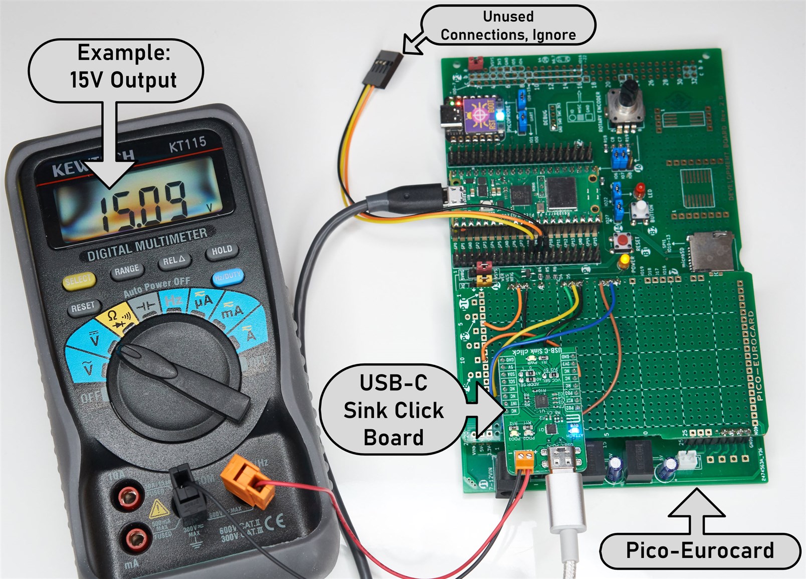

This quick blog post describes a simple Pi Pico based tool for getting different voltages out of mobile phone chargers.
Using this project, it can be possible to obtain 5V, 9V, 12V, 15V or 20V out of a phone charger, and this could be handy for all sorts of purposes. However, this is not a complete project; it is more for experimenting with USB-C PD. I definitely wouldn’t recommend this project to act as a standalone power supply for instance, please don’t try to misuse this project for that purpose. It’s strictly for experimentation. There’s no current-limiting, and no error-handling. Also, not all USB-C chargers will support the five voltages listed above. For instance, Anker chargers seem to omit 12V capability.
The project supports USB-PD version 2.0 capabilities. There is a more advanced capability called PPS which would allow more granular voltage setting, but that requires USB-PD 3.0 support, which this project does not have.
How is it Used?
This project is in effect a Python (actually MicroPython) library. You can load it onto the Pi Pico, and then type Python commands to choose what voltage you want. If desired, the project could be easily extended to have button inputs, since it’s just a bit of Python code that anyone learning MicroPython on the Pico will be comfortable doing.
What’s Required?
The diagram in the introduction shows the physical topology and the items required. The USB-C charger needs to support at least USB-C PD 2.0. I have tried an Anker charger and a UGREEN charger, and they both functioned with this project. Many other chargers and power supplies will function too, provided they specify that USB-C PD 2.0 or 3.0 or higher is supported.
A board is needed that contains USB-C PD ‘Sink’ capability. I used a USB-C Sink Click board, but any other board that contains the STUSB4500 chip should be fine. A Pi Pico , or any other board that supports MicroPython is needed for this project. I have only tested with Pi Pico.

The Pico-Eurocard could be used for this project:

If there is a multimeter connected to the output connections on the USB Sink Click board, then you’ll see the output voltage change to 15V.
