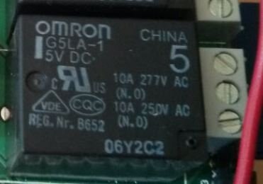

One of the things I wanted to do with my Pi from the outset was to be able to use it as a timer, to turn a light on and off at night when I was out, as a simple form of home security. Being something of a newbie when it comes to electronics, my biggest problem was how to wire it up to be able to turn the power on and off.
The Pi relays are rated at a maximum of 20v and 5amps - therefore I cannot connect the Pi directly to the 'mains powered' light !!!
What I am planning on doing is investigating using a to a commercial relay which can cope with the current. When I've done that I shall update this blog again with details of the how the Pi can safely control a mains powered device.
However, the rest of the blog is still valid as it explains how the relay on the PiFace is operated and will be used for the Timer application, when completed.
I've written a java program to control the light switching on and off which does the following;
  • Calculate a random wait time between two values that I have supplied (2 and 20 minutes at the moment)
  • Wait for that period of time to elapse
  • At the end of the wait time, toggle the relay - switch it on if it was already off, and vice-versa.
  • repeat the above ad infinitum
The result is that the light will keep turning on and off in a random pattern making it look as if someone is using the room even when I'm not there !

    I agree 100% with mark on this one.
    Also, just because the relay can handle the 250V at 10A, does not mean that the board it is on can or should, it is all about how the board is designed, built and protected from other things, when dealing with Mains voltages there are very clear guidelines regarding PCB trace spacing. creapage allowances etc that MUST be followed for a module to be certified safe. This includes how it is boxed
    in the case of a PIFace, it would never get a CSA or CA or UA etc approval sitting on top of the primary RPI board with nothing more than the connector preventing it from contacting the main board or a finger getting to the high voltage connectors
    It is a low voltage design through and through. If there are no warnings on the board then perhaps there should be but there are warnings in the documentation

    Oh, sorry, I didn't mean to concern you. I thought was the relays rated at a relatively low voltage(maximum 50v), not just the board, that would explain a lot. another relay would be fine, but adds another point of failure.
    mcb1 over 12 years ago in reply to kidiccurus
    Also, I am surprised that  the relay didn't spark and fail in a spectacular cloud of smoke.
    Now you are concerning me with your knowledge.
    The relays are clearly marked for 250v and 10A so why would they "  spark and fail in a spectacular cloud of smoke.  "
    The light Peter was switching was 230v (YES HE SHOULDN"T BE) but the current is likely to be less than 1 Amp.
    There is no reason at all why the pi-face can't control another relay that switches the 230v portion.

    I know the issue and I know many people don't read the comments but I try and leave them anyway. There is a chance it could save someone's life. A very small chance but a chance nonetheless. And I believe that chance is worth the minute it takes me to leave a comment. Also, I am surprised that  the relay didn't spark and fail in a spectacular cloud of smoke.
    While you might be right, most of the novices that do don;t read anyway.
    The point of the above (now resolved) was that 230v Mains was being switched on a board that WAS CLEARLY MARKED as 24v maximum.
    I'm afraid you're never going to stop the 'ignorant' out there playing with Mains voltages.
    All you can hope is that those who do want to learn can find the safe way to do things.
