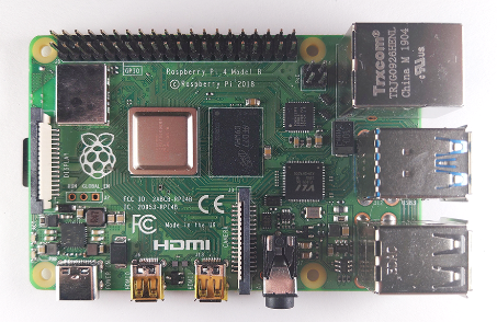

Raspberry Pi 4 Model B Frequently Asked Questions (FAQ)
NEW! Raspberry Pi 4
Technical Specifications | GPIO Pin Out | Benchmark Tests | Comparison Chart | FAQ | Quiz | Pi Accessories | Pi Projects | RoadTest

What about projects using the old board? Can I easily swap to the Pi 4 Model B?
While the new Raspberry Pi has the same form factor and General Purpose Input/Output as previous models, so should practically allow for a drop-in replacement, there are some notable changes.
You will have to consider the new layout of the connectors on the board along with the change in power requirements.
Extra attention should be paid to the need for cooling for the board if you're running it under strain to gain the maximum speed out of it without thermal throttling.
There have also been changes to the processor on the board which means it will identify differently. Also, there is a new graphical processor on the board which supports slightly different instruction sets.
This means there will be slight software changes as well to how the hardware identifies itself. You can read the following document for more information: Raspberry Pi 4 Model B - Technical Specifications
