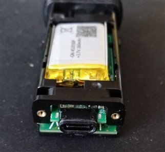

From the outside, beside the on/off switch and the LED indicator, it is noticeable the presence of a particular kind of USB-C port. On closer inspection, on either ends of the device there are some rubber gaskets, which is a strong indication the device could have some sort of waterproofing.
Checking the USB-C port, it is rather evident it is really a special port: the photo on the right shows there is some rubber sealing around it, which suggests it may indeed be a waterproof USB-C port (similar to this) , possibly rated as IPX7 or even IPX8 (the "X" is due to the port not being classified for the protection from ingress of solids).
My bet is that the device is waterproof, resistant to accidental splashing of water, and possibly to some very short-time submersion in shallow water (<1m), but since I could not find any reference about IP rating in the official device literature, I would not try dipping the SmartEdge in water as yet!

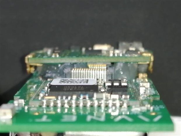

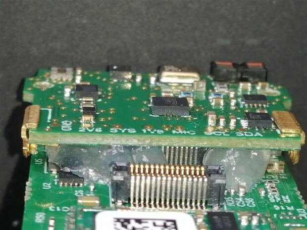

The main board features two board-to-board connectors, used to expand the system. One of the connectors is used for the Sensor Board V1, and the other is available for adding an alternative connectivity board. AVNET has clearly made an effort to make the device as flexible as possible, to accommodate customers' specific requirements with minimal effort.

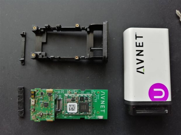

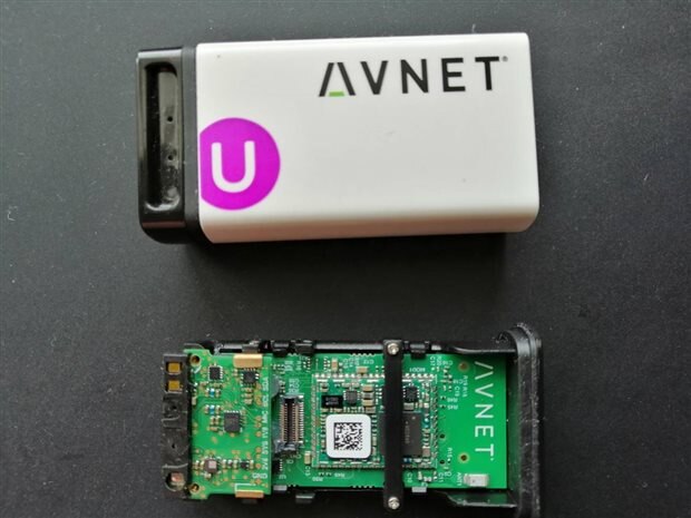

{gallery} A look inside the SmartEdge Agile
SmartEdge Agile: On the left, you can spot the sensors board, and the protective gasket (far left)
SmartEdge Agile: Removing a few screws, the boards are freed from the "chassis". Removing the gasket reveals the actual sensors (far left)
SmartEdge Agile: A close up of the boards. At the bottom there is the main board,and on top of it there is the sensor board. It is visible the board to board connector, used to add functionalities to the main board.

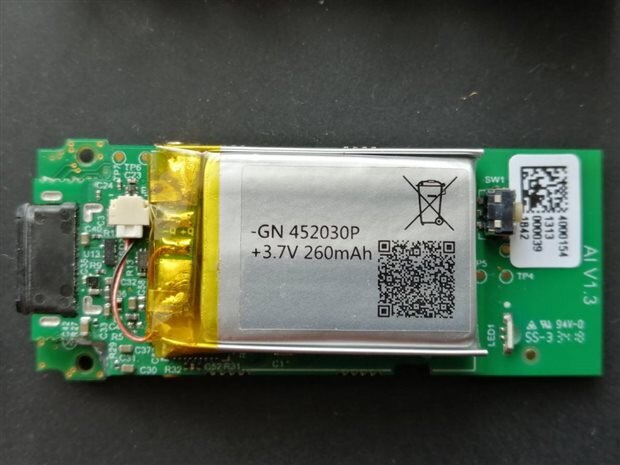

SmartEdge Agile: The back of the main board hosts the 260mAh Li-Poly battery. The USB-C connector is visible on the far left, while the On/Off button is located on the right (near the QR code)
SmartEdge Agile: This photo shows how the sensors board is connected to the main board.
SmartEdge Agile: A close up of the free board to board connector.

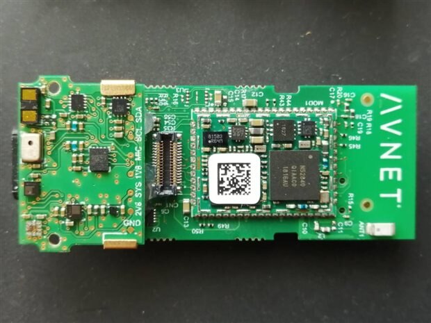

The device I have been given, has the main board and the sensor board V1 configuration. The main board (BRAIN module) is built around the STM32 32-bit microcontroller, and uses a Nordic nRF52840 Bluetooth 5 SoC for low power connectivity.
While it was easy to spot the nRF52840 on the board, the STM32 microcontroller was covered under the QR code. Gently lifting up the sticker revealed the MCU is indeed the STM32L46QG, an ultra-low power ARM Cortex-M4F. Looking at the specs for the Nordic SoC , I cannot help but wonder how taxing is, in terms of processing power needs, the "AI Engine" hosted on the board: in addition to all the Bluetooth 5 LE and the communication facilities (like encryption, etc...), the nRF52840 is also equipped with a rather powerful 32-bit ARM Cortex-M4F core. Surely, judging from the datasheet alone, the Nordic Soc would be more than capable of managing the sensors and the communication, making the STM32 redundant. Obviously mine is merely a speculation as unfortunately, for the AI side of the product, there is very little information available.

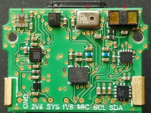

The little board accommodates quite a number of sensors, and looking at the markings, they are all connected via I2C (from the photo on the right, amongst all the test points, we find the familiar SDA and SCL pads, which is probably the test access to the I2C bus where all the sensors are connected). Unfortunately I cannot verify this taking actual readings from the test points, as I don't have anything I can use to make a stable contact with the pads, and trying to solder anything on such minuscule 30MIL test points is way beyond my capabilities (and tools).
On the board there are the following sensors:
  1. Light Sensor: AMS TSL2540
  2. Temperature/Humidity Sensor: STMicroelectronics HTS221TRl
  3. MEMS Microphone: STMicroelectronics MP34DT01-M
  4. Time-of-flight (Proximity) Sensor: STMicroelectronics VL53L1CXV0FY/1
  5. Pressure Sensor: STMicroelectronics LPS22HB
  6. Inertial Measurement Unit (Accelero/Gyro) Sensor: STMicroelectronics LSM6DSLTR
  7. Magnetic Sensor: STMicroelectronics LIS2MDL
The task to supply power to the board is assigned to the Li-Poly 260mAh rechargeable battery.
This small battery ensures the device can work from a minimum of about 18 hours, with all the sensors enabled and collecting data at fastest sampling rate, to a maximum of 22 hours, with only one sensor (temperature) enabled and collecting data at the slowest sampling rate. The battery can be recharged using the USB-C connector, and takes about 3.5 hours to fully recharge from flat.
