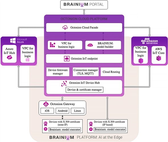

The software side of the solution provided by Brainium, offers a complete device-to-cloud IoT platform, which also includes AI capability. The backbone of the platform is based on the Octonion IoT framework.
Brainium is developed as an application built on top of this framework, which adds AI to the IoT management functionalities already available through Octonion’s platform. The main components of this architecture are:
  • device
  • gateway
  • cloud
Looking at the picture illustrating the architecture, Brainium appears to be quite a flexible solution, capable of integrating with both the major cloud players in the industry and with custom private cloud infrastructure.
If your hands are already itching thinking of the possibilities, just take a deep breath: for the roadtest, or if you only buy the Agile device, you can only use the 6-month trial Microsoft Azure-backed cloud infrastructure, and if you want to explore any other integration path, or investigating any further customisation option, you will have to get in touch with an AVNET representative. After all, let’s not forget the focus of this product is to engage with manufacturers, not makers/hackers.

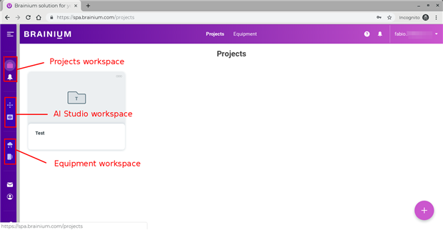

No matter how many components will be at work behind the scene, the user will always perceive the platform through its user interface. When I logged into the Brainium portal for the first time, I found the interface to be quite easy and clean. I also found the philosophy behind the organisation of logically linked functionalities into workspaces, to be a big help while moving the first steps. The workspaces are: the Projects, the Equipment and the AI Studio. Each of them manages and presents a different view of the platform, trying to avoid overlapping: the Equipment workspace is all about the physical platform management (i.e. adding/removing gateways and devices), the Project workspace is the operational view of the system (i.e. management of what data to collect, creating monitoring rules, visualisation of the data collected), and the AI Studio is the tool that deal with the creation of AI models and the training data sets.
{gallery} Brainium Portal
Portal: The different workspaces, logically grouped
Equipment workspace: Gateways
Equipment workspace: Devices
Project View: Devices
Project View: Widgets
If, on one hand, the clear separation of the functionalities is a big help, on the other hand it can make "operational workflows" (e.g. setting up an alarm for a device, monitoring a sensor, etc.) a little less intuitive. It is not a big deal, as you get used to it once you go through the process couple of times. But let me explain what I mean with an example.
Everything related to the operational view of the platform belongs to the Projects workspace, more precisely, you need to create a Project. The Project, to do anything meaningful with it, needs to have at least one device assigned to it, so that the user can manage, monitor and/or create alarms for such device. But devices, in order to be "assignable" to a project, they need to be added to the system first, and this can only be done from a different workspace: the Equipment one. So, if you haven't added any devices to your system yet and you create a Project, in the middle of your Project setup, you need to abandon what you were doing, to switch workspace to Equipment->Devices,  add a new device, switch back to your Project and then retry assigning a device, which is not ideal. Would have been more "user friendly" to include a "shortcut"  in the Project: an "Add  new device" entry in the drop-down list of the assignable devices, that would take you automatically to the "Add device" workflow defined in the Equipment workspace to perform the action, and then take you back to the Project workspace where you left.
