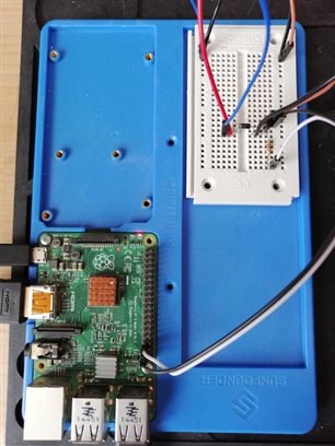

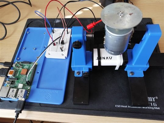

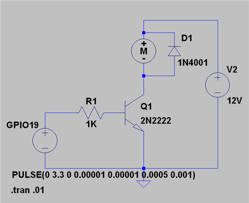

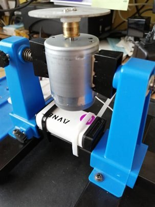

To do so, I have tried to reproduce a use case, typical for this kind of maintenance tool: monitoring of a motor’s vibration during operation. I set up a very basic test bench, using a 12V DC motor, driven by a PWM signal generated by a Raspberry Pi 2 GPIO pin.
The motor has been secured using a PCB clamp and some bi-adhesive tape, and the SmartEdge Agile device has been attached to PCB clamp using cable ties. The photos below show how the test environment has been set up. I have fixed a big washer on top of the motor, aiming to "amplify" the vibrations generated by the motor.
The motor is driven using a 50% duty cycle PWM signal (from GPIO19 pin of the Raspberry Pi2), and the circuit used is shown below.
Once the circuit is wired and working, a python script is used to control the motor’s operation. For the machine learning training, the assumption is that the normal operation of the motor would encompass the following static and dynamic states:
  • motor off (static)
  • motor transition off to on (dynamic)
  • motor on (static)
  • motor transition on to off (dynamic)

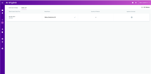

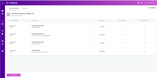

Initial learning
For the the initial learning, the motor is started repeatedly and run each time for 1 minute. The vibration patterns are discovered as the learning progresses.The result of the initial learning is pretty good: all the states listed above are detected, and no other “spurious” pattern has appeared. Each repeated run of the motor keeps detecting the same pattern, denoting those as stable vibration patterns.
This is a good baseline to generate the model with.
{gallery} My Gallery Title
Initial Learning
Model Creation

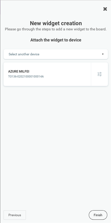

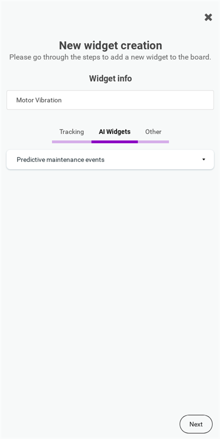

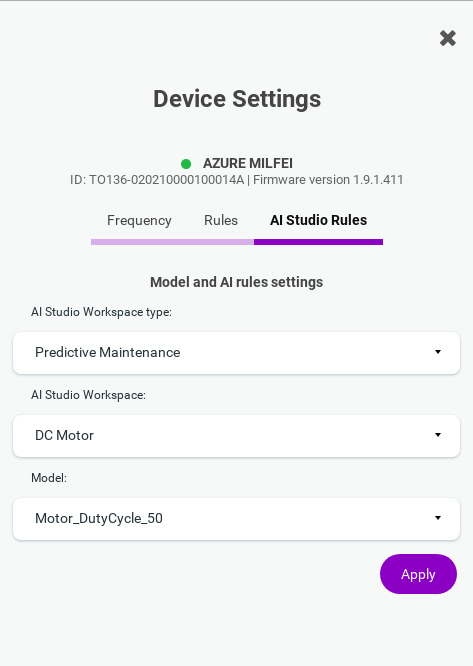

With the model created, now we need to add Widgets and Rules if we want to monitor our motor. Before any AI-related Widget or Rule can be created, we need to specify which AI Workspace and AI Model we will be using. The creation of the AI Widget, besides allowing the monitoring of the vibration prediction events, marks the start of the continuous learning on the device target of the Widget: from that moment on, any new patterns detected will show in the list of the patterns (in the AI Workspace), and can be later used to "grow" the model.
Selection of AI Workspace and Model
AI Widget Creation 1 of 2
AI Widget Creation 2 of 2
AI Widget visualisation
AI Rules creation

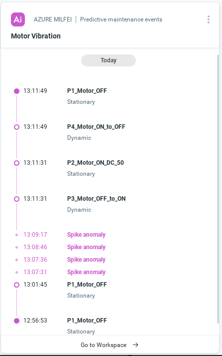

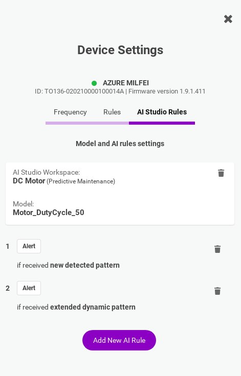

The AI Widget (as shown in the screenshot) lists not only the known vibration patterns, but also any newly recognised one, and will also show any spike anomaly. Spikes are easily generated, especially in my test setting, as it is enough to lightly tap on the desk to cause a spike to be detected (this explains also the numerous spikes shown on the screenshot, due to my not-so-gentle handling of the PCB clamp!).
The last operation to perform, before actually start testing the detection of anomalies, is the creation of rules. As said before, the rule specifies the "trigger/threshold" the SmartEdge Agile device needs to react to, causing to send alarms back to the Brainium platform if the condition is met. For the test, I have added 2 rules for the alerts: new detected pattern event and extended dynamic pattern. The new detected pattern event would cover any quasi-stationary change (for static patterns) and quickly varying transitions or anomaly (for dynamic patterns), while the extended dynamic pattern event would cover all the anomalies that cause a prolonged transitional pattern.

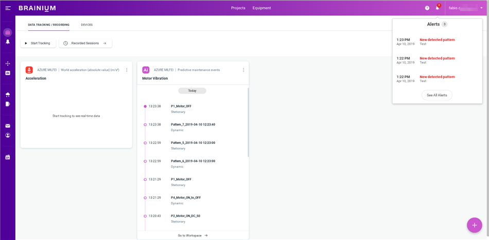

Now that all has been set up, it is time to test the anomaly detection. To cause such anomaly, I have chosen a very scientific approach: used a pencil with a small rubber on the tip, and use to "mess about" with the washer attached to the motor image. In a real life scenario, this kind of anomaly would be caused by some foreign object coming into contact with the motor, like some dirt (admittedly quite a big object, considering the size of the pencil compared to the motor).
Armed with my pencil, I have applied some force, which slowed down the rotation speed, and kept it that way for a few seconds, and finally removed the pencil. The results are visible in the screenshot below.
As it can be seen, the interaction generated 3 new patterns, as expected: 2 dynamic pattern (steady speed to lower speed and lower speed back to steady speed) and 1 static (the lower speed  maintained while the pencil was touching the washer), so the detection algorithm behaviour seems quite consistent, and worked quite well. The patterns have been recorded and the alarms received, and several spikes (not shown in the screenshot above) have been detected as well, consistently with me touching and tapping the PCB clamp.
The video below shows one of the motor runs used to check if the 4 standard patterns, used for the training and used to generate the model, were detected correctly by the SmartEdge Agile.

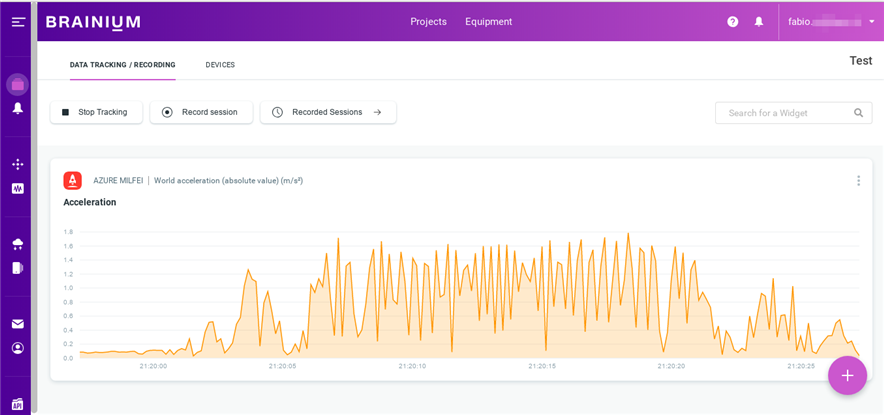

After the test, I wanted to check if I could get some actual data regarding the vibration pattern, using the World Acceleration Widget to record the data stream (with the device tracking rate set to extreme). The aim would be to see if I could get good enough data to perform some processing and get more insights on the vibration pattern and, more importantly, on the anomalies.
I have created the widget and recorded data of a sample, undisturbed, motor run. The graph for the data reading is shown below.
From the graph, I can identify the 4 vibration patterns (from the left: motor off, motor off to on, motor on and finally motor on to off). The impression I got, for the motor on pattern, is that the data have been collected at too low sampling frequency (undersampled). Typically, vibration frequencies spectrum can extent from few Hz to 10kHz, although for our test (motor's max speed 6000 RPM, duty cycle 50%) the speed in the motor should be about 3000 RPM, which give us a fundamental frequency for the vibration at 50Hz, and if we limit the spectrum to the 5th harmonic, gives us a bandwidth of 250Hz for the spectrum.
Nyquist-Shannon sampling theorem tells us that, to correctly sample a signal, we need to make sure the sampling frequency is at least double of the maximum frequency component of the sampled signal, which in our case means a sampling frequency of at least 500Hz.
But the only data we can have access to are the ones coming from the widget, and unfortunately it looks like the samples are collected at a rate of roughly 10Hz, well below what we would need to be able to extract any meaningful information from spectrum analysis!
Obviously, this "cut-down" data rate is probably due to some bandwidth optimisation done by the Brainium team, to reduce the amount of data needed to be transmitted to the cloud from the SmartEdge Agile, and probably most of the time this is the most efficient choice, but it feels quite limiting not being able to retrieve the data we know are available on the device, or at least be able to set the sampling rate for the data requested to be sent back to the widget.
I know Brainium is quite customizable, so probably the development team would be able to change this, if required. But this would involve engaging with AVNET, while I think there would be value making this option available to all the users regardless.
