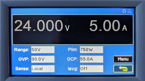

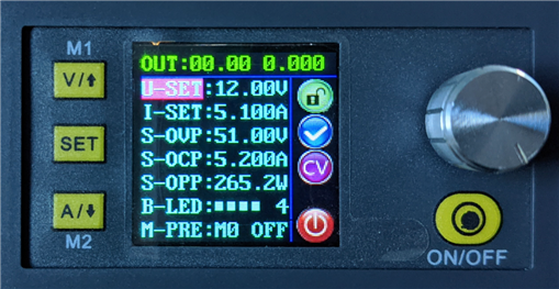

The settings are usually set up by some kind of user interface.
This is what it looks like on the AIM-TTI QPX750SP:
and the RD Tech DPH5005:

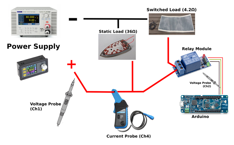

In order to test some features of the power supplies, I needed some kind of dynamic load.
Initially, I wanted to build a DIY Electronic load, but I decided to postpone this project, as it may take too long to build.
Instead, I came up with this simple Relay Module + Arduino based setup:
The setup consists of two resistive loads connected in parallel: a 36 Ω static load and a 4.2 Ω load switched by a relay module.
The relay module is controlled by an Arduino MKRFOX 1200, programmed to switch the load ON / OFF every 10 seconds:
  • when the relay is OFF there is a single 36 Ω present
  • when the relay is ON the combined load is 36 Ω + 4.2 Ω = 3.75 Ω
Two oscilloscope probes are connected to the output of the power supply, and the control signal of the relay.

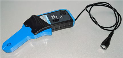

This time, I also included my newly arrived "cheapo" Hantek CC-65 AC / DC Current Probe image
Using this setup I conducted a set of experiments to observe the behaviour of the two power supply at different dynamic events.

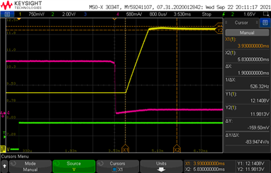

3. Load Regulation Behavior
In the first experiment, I wanted to see how the two power supplies handle changing loads.
For this, I used the above described setup and I set the oscilloscope to trigger on the rising / falling edges of the relay control signal.
I measured the time it take of the output voltage to stabilize, and as well any over / undershot.
This is what I got for the Aim-TTI QPX750SP:
Aim-TTI
QPX750SP
Time to Stabilize
(ms)
Under / Overshot
(mV)
Waveform
36Ω ⇒ 3.75Ω
~ 3 ms- 570 mVimageimage
3.75Ω ⇒ 36Ω~ 2.5 ms+ 480 mVimageimage

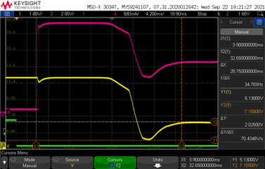

4. Current Limiting Behavior

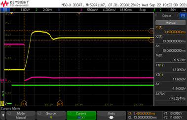

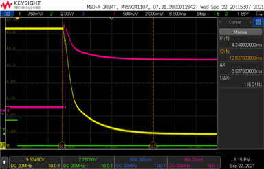

Next, I wanted to see how the power supplies changes from Constant Voltage (CV) to Constant Current (CC) modes, and vice-versa.
To do this, I set the current limit to 2.0 A, on both of the power supplies. The 3.75 Ω combined load is supposed to take around 3.2 A @ 12V, so it should be current limited.
These are the results for the Aim-TTI QPX750SP:
Aim-TTI
QPX750SP
Time to Stabilize
(ms)
Under/Overshot
(mV)
Waveform
36Ω ⇒ 3.75Ω
(current limit
turns ON)
28.75 ms- 2.02 Vimage
3.75Ω ⇒ 36Ω
(current limit
turns OFF)
10.05 ms+ 1.44 Vimage
RD Tech
DPH5005
Time to Stabilize
(ms)
Under/Overshot
(mV)
Waveform
36Ω ⇒ 3.75Ω
(current limit
turns ON)
8.58 msnoneimage
3.75Ω ⇒ 36Ω
(current limit
turns OFF)
~ 1.9 ms+ 160 mVimage
5. Short Circuit Protection
Bench power supplies are supposed to be able to handle short-circuits (accidental or deliberate).
To test short-circuits I replaced the 4.2 Ω switched load with an 30 A automotive fuse simulating a short-circuit.
Then, I measured how fast the two power supplies react to the short-circuit event.
This is what it looked like for the Aim-TTI QPX750SP:
Aim-TTI
QPX750SP
Time to React
(ms)
Waveform
36Ω ⇒ 0Ω
(short circuit)
0.720 msimageimage

6. Conclusions
Interestingly, the cheap RD Tech DPH5005 power supply was able to handle most of the tested events faster, compared to the Aim-TTI QPX750SP.
Also, with the particular test setup I used, there are fewer over / under-shots and other artifacts produced by the RD Tech DPH5005.
On the other hand RD Tech DPH5005, produces a noisier output. This is what observed at the static load tests too.
Although, being "faster" looks to be a good for a thing for a power supply, it may not be the best in all cases. I'm not an expert, so would avoid drawing any deeper conclusions here image.
